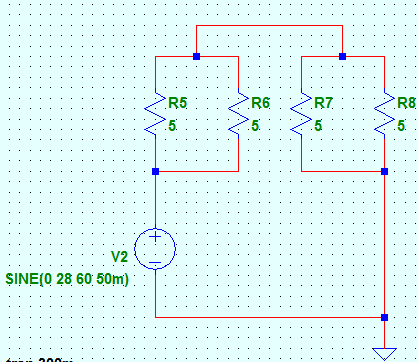

I have a circuit that I need to modify, the operating principles of the modified circuit have to stay at same as original circuit, or as close as possible. Basically I have a heating circuit with 4, 5Ohm 50W resistors as shown in the schematic below. (the original circuit)
The problem is that the source voltage is going to change to 120VAC instead of 28VAC. In the original circuit each resistor generates about 39W of heating power for a total of about 156W.
I can't change the original resistors.
I can add resistors, I have many different type.
I can use a transformer to drop the 120VAC down to the 28VAC. (Trying to avoid this).
Any Ideas will be appreciated.
Your drawing seems accurate, your description has a typo. They are 5Ω, not 50Ω.

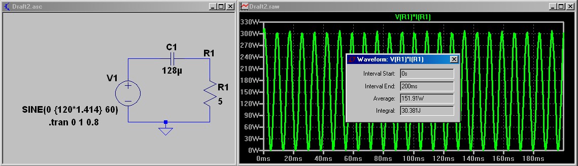

If you are stuck with 5Ω, you could do the following: The capacitor must be rated for the AC voltage and ripple current. Try a motor starting capacitor **broken link removed**. Since the values of these are approximate, you may have to parallel two to trim the current...
