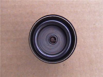

Try a heating element out of a cigarette lighter (usually free) and feed it with ~3.6 V from a Lithium cell. Am guessing it will rise 40F to 4 ounces in a minute or two. Play with voltage and heat shielding to tailor results.
