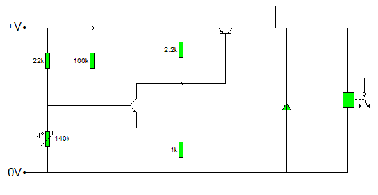

Hi, friends! I intend to build a simplest 110 VAC electronic controlated heater to use in my aquarium. I would like do make it at the most simple (and sheap) possible, therin a opted to use a thermistor as themosensor and SCR and Triac as charge switches, and wich control circuit could work not using DC Power but directly AC power. Can someone help me? Thanks a lot. (P.S.: I ask you to excuse my "not so good' English, I'm braziliam...)

Use a small linear poer supply as the DC source of this circuit.
Thank you all, guys, for your answering and worrying. I'm even that water and high voltage is not a good combination to play with, and I promise I will be careful with this. But, once dealing about sink heater, it's unavoideble... I know too so that using DC, and rellays as switch, it is more simple, safe and apropriated (and was already decided for this way) but, quite so, my problem (doubt) still stays: how to make a thermostat, that uses a thermistor as a sensor, work directly in a 110 VAC, without a properly DC power source device?

You can use a transformerless power supply but it probably won't be able to supply enough current for the relay coil in my circuit but I'd recommend using a small transformer rectifier and capacitor.
0k, Hero999,
Thank you for your atemption. I will consider your sugestion. I was trying to avoid DC power suply, but it seam more dificult than I thougth.
