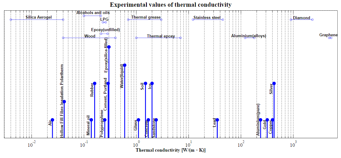

Which Raytech Magic Gel did you find suitable, except for price? The one I looked at, MagicGel 300, has a thermal conductivity of 0.2 W/mK (https://uk.farnell.com/raytech/magi...lymer-gel-300-ml/dp/1663039?CMP=GRHB-OCTOPART , then click on Technical Datasheet).
By comparison, Hysol GR750 has a conductivity of 2.1 W/mK.
If 0.2 W/mK is good enough, you could take ordinary epoxy or almost any potting rubber and fill it with fumed silica or alumina and meet or exceed that value. As for cost, the Magic Gel is $20.08/300 mL. That is not terribly expensive compared to similar, two-part RTV silicones.
To put some of the thermal conductivity data into perspective, this chart from Wikipedia might be useful:
