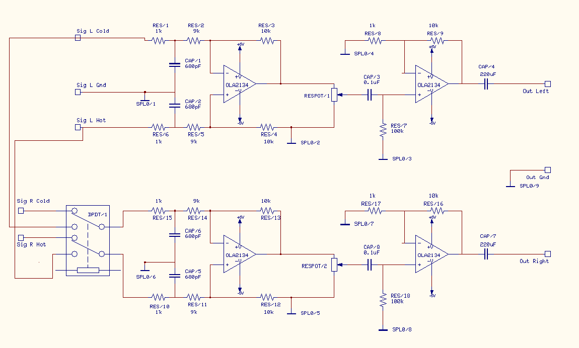

What do people think to this circuit? it is essentially the CMoy circuit with his balanced-to-unbalanced circuit added to the front end. All grounds would be the ground of the left input signal, and isolated from the case.

I think the CMOY sucks ass. If the OPA2134 was suitable for a headphone amp then TI would market it as such. They don't. Stupid audiophiles popularized this because it is simple. Simple does not mean good.
You can build a *slightly* more complex circuit that is much, much better and has been around a long time. It uses an opamp (a 2134 would be great) to feed a pair of push-pull emitter followers (BD139/BD140 transistors). The transistors are biased using 1N4148 diodes and resistors. It is all very simple to understand.
The push-pull transistor pair itself would have quite a bit of distortion, but they wrap them inside the feedback loop of the opamp which compensates for all of it.

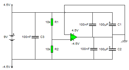

A µA741 would do the job, especially if ihe stuck 100µF capacitors from the output to either side of the supply, that way it wouldn't be doing much at AC.

Above DC the two capacitors form low impedance paths to the supply, thus bypassing the output of the op-amp. At 20Hz they'll be about 80Ω each so the total earth impedance will be half that because they're effectively in parrallel so that's 40Ω and if you need a lower impedance then use larger capacitors.
It doesn't matter if the op-amp can only output a few mA because at AC it's not doing any work, C1 and C2 are powering the load. You only have to worry about the op-amp's output current at DC. In this case it's DC is only being used to bias the amplifier and the current is very small - no problem for the op-amp.
