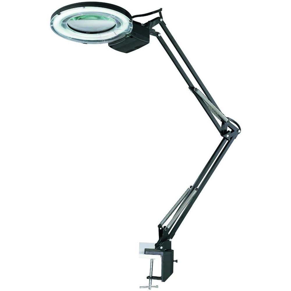

...Which magnifiers are popular...
I would say these qualify as "popular"
----> https://www.destinationlighting.com/images/products_zoom/439/P687439~zoom.jpg

I have 2 or 3 handheld magnifiers, the glass ones seem better, maybe all the acrylic lenses I've tried have been poor quality.
A bench magnifier is something I do have, personally I find it gets in the way a little too much.
