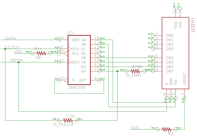

If I put the HD44780 into a read mode its pins become outputs. If I do not tristate the 74HC595 driving it, will the pin pairs with 1's and 0's flow enough current to burn out either the LCD driver or the 595?
If so would putting current limiting resistors between the 595 and LCD prevent the problem?
FWIW the attached schematic shows how I would like to read the busy flag back through the 595's clock line. The LCD and the 595 will attempt to drive each other while I do the shifts to tristate the 595. While debugging it is possible that the program may be halted with both driving.

The 74HC595 has tri-state outputs controlled by pin 13 OE aka G. I can not use the r/w line to control OE because the r/w pin will be tristated. The serial out pin is an output regardless of OE so it is the only candidate for controlling OE.

As it's currently connected how do you write a zero to D7 as /QH is connected to /OE? BTW, it is in not just D7 that becomes output, it is D4-D7.

You are right about needing current limiting resistors on D4-D7. I am fairly sure the current limiting resistor(s) should protect the parts when both are outputs but in different logic states. But I have not seen it done. I am still an not 100% sure they are needed. This is sort of similar to having two or more devices that can drive the same bus. As a rule only one is on and the others are tristated. What happends when more then one is turned on?
I was speculating that 2.2K (or maybe 10K would be better) resistor between /OE and the D7 would work like a pullup/pulldown resistor and be overpowered by the 74HC595 QH output. This would allow one to write a zero on D7. Again I am unsure and thus the question.

The problem is with all data bits, when D7 is zero then /Q7 is one and so ALL outputs are tristated.

I think you misunderstood what I was trying to say. With QH=0 then /QH=1 and therefore all the outputs from the 595 are tristated. This makes it impossible to write say 0001 to the 4 data pins of the LCD. Not to mention that RW and RS will also be floating. Even if you move the data lines along a bit the control lines will still be tristated when reading.

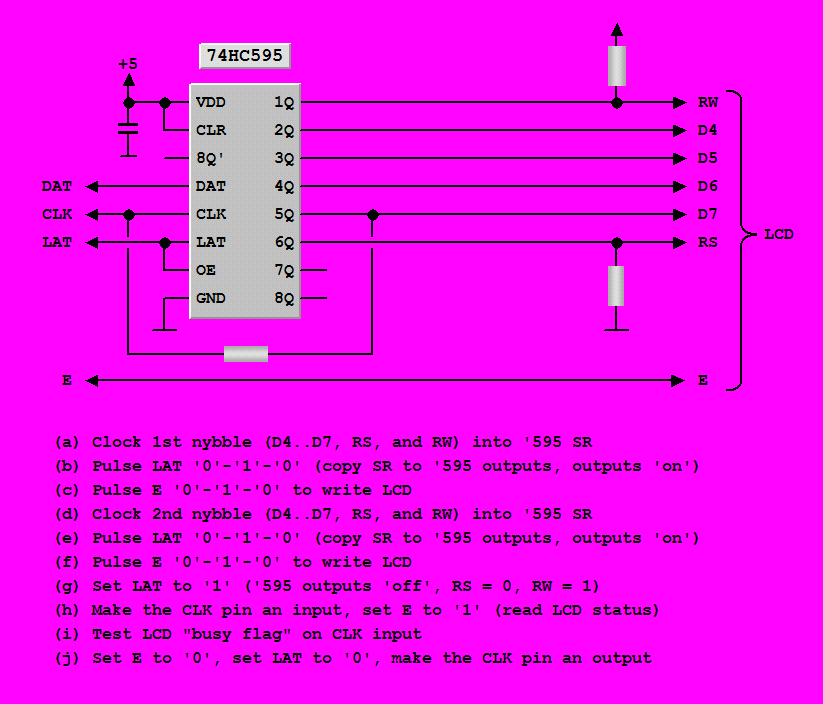

Hi 3v0,
How about this?
<> Tie the Latch/Strobe/RCK pin (12) and the Output Enable pin (13) together (driven by your "latch" signal).
<> Loose the resistor between the '595 QH output and the D7 pin on the LCD.
<> Put a pull-up resistor on the LCD RW pin so that it's a '1' (read mode) when the '595 outputs are tri-stated.
<> Put a pull-down resistor on the LCD RS pin so that it's a '0' (command mode) when the '595 outputs are tri-stated.
Here's what I suspect would be the LCD write procedure;
(1) The "Latch" signal is normally hi ('595 outputs off).
(2) Clock 8 bits into the '595 shift register.
(3) Set "Latch" signal lo ('595 outputs on).
(4) Toggle the 'E' line to send command or data.
(5) Set "latch" signal hi ('595 outputs off, RW = 1, RS = 0)
(6) change your CLK pin to an input
(7) Set the 'E' line hi, LCD outputs status byte
(8) Read D7 status on CLK pin
(9) Set the 'E' line lo, TRIS CLK back to an output
This means your "Latch" signal is normally hi and the '595 outputs are tri-stated between LCD write operations.

<added>
Just realized the procedure would be slightly different using LCD 4-bit mode but hopefully you get the idea...
I was thinking about a similar circuit yesterday :) In short use pull ups and downs to force a data read when the 595 is tristated. But I was using the serial-out (QH*) to drive the 595 OE pin. This is ugly because you need to clock the bits in twice. Once with E low and again with E high.

Which puts a read on the LCD's input. E is is high and as it goes low the next command will be showing up on the 595's output. The data is clocked into the LCD on E falling. I was a bit worried that the LCD would latch before the data on the 595's outputs had settled.

Now I think the LAT line (connected to output enable) should be low between write operations. New procedure below. I'm not sure when I can test this.
Regards, Mike

3v0,
Did you notice the method in the '595 data sheet to combine the SRCLK ('CLK') and RCK ('LAT' or 'STB') signals for a 2 pin interface?
