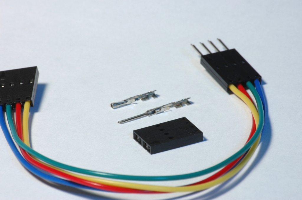

I normally use the Molex SL series, they come in a large variety of styles. I think the Tycho/AMP equivalent is their MTA series. There is also KK and C-Grid from Molex. You would have to be able to crimp the wires yourself. Here is a photo of a male to female connector I made with the SL series.
