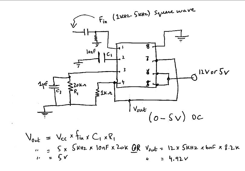

I have seen that a lot of people have experience with this chip and i was able to find a lot to help me out but now i'm kind of stuck and need advice.
I'm using the 8-pin LM2907N-8. Attahced is the data sheet and circuit.
I'm getting the Vo of just 3.23 max with Fin of 5khz. The lower values are fine (1v = 1khz, 2v = 2khz and 3v = 3khz) approx but not getting the 4v and 5v out.
Even changing the voltage input doesn't make a lot of difference.
Freq input is square wave 5v pk-pk. R1= 20k, C1= 10nF, R= 1k & C2 = 1uF.
I did tried according to the data sheet but it was giving funny readings (very less) but i'll try it again as see what it does.
Plz give any suggestions and advice on it :confused:

The maximum output voltage of your circuit is 2.3V less than the supply voltage. If the supply is only 5V then the guaranteed max output voltage is only 2.7V. Some ICs have a little less loss.
Increase your supply voltage.

thanks for the reply. I have increased the power supply but it was still the same. However i got what i needed on pg 16 (changing techometer gain curve or clamping the min output voltage).
Its working fine :D in this config but i'm having current issues (when chip connected). when i use a potential divider for bring it from +12v to +10v.
any ideas? why?
A potental divider has terrible voltage regulation. The output voltage changes when the load current changes.
You need the supply voltage regulated at about 8V, not 10V.
You could copy the zener diode circuit in the datasheet or use an LM317 adjustable voltage regulator IC.

The circuits that have an output voltage when the input is zero Hz use a regulated 10V supply so that two resistors provide the offset voltage.

However, I came to know that I had +15V on the other circuit board and instead or lowering it down it was better to just use it. So, I changed the Values to C1 = 1nf, C2 = 470nf & R1 = 66.67K (100K//200K). Its giving quite a linear Voltage out to freq out.
I have tested the F/V chip.
Well, it doesn't has any floating voltage when there is no Freq input going in. It seems fine :)
I think I forgot to mention from where I got the details for the linear Vout to Freq out. ITs on the data sheet on pg16 'Changing Tachometer Gain curve or Clamping the min output volts'.
