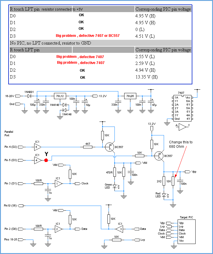

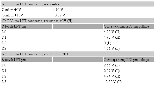

You can only be sure that it is not the software that gives these strange behaviour by testing the hardware "without" the PC. I suggest the following procedures for anyone building such programmer:
1. Do not connect to PC and do not place PIC into socket.
2. Power up and confirm +5V and +13V healthy
3. Prepare a 100 ohm resistor and connect one end of it to +5V
4. Connect voltmeter to corresponding PIC socket pin and touch the other end of the resistor to the programmer's parallel port input pin. Watch if the corresponding PIC socket pin change from low to high or vise versa. Log the result.
5. repeat the test using one end of the resistor connects to 0V.
This would completely checks out the functioning of the hardware circuit.
Do not place a PIC in the socket yet.
The next test is to connect up the parallel cable and use the software interface "test" to check that the signal from the PC can actually controls the voltage on the PIC socket.
Now one can place a PIC into the socket and enjoy.

It's VERY important to switch Vdd
This is what I didn't know - since I assumed that it is only used to scale Data and Clock, and since I read in specs that it is OK for them to scale up to Vdd 5V even for a reading operation (just as long as you're in prog mode), i thought it would be Ok to keep it at 5 at all times :) - hoping that
Thanks so much for this! Maybe some of you guys could do a sticky post on a few methods for hardware troubleshoot of homemade programmers? I was for instance completely ignorant that :
- parallel port pins should be measured via a (pull-up) resistor? I always bunked the voltmeter directly to them and measured towards directly towards ground :) unlike
tips like this are a must for anyone just starting with this stuff, thanks :)
No that was not what I meant. Sorry for causing the misunderstanding. The above step 4 amended to give a clearer meaning.

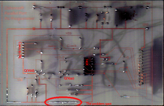

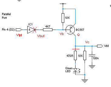

Did some measurements..
Hi all,
I got back to the Oshonsoft version of Tait parallel programmer that I slaughtered, and implemented the following suggestions I got here: I returned the Vdd switching transistor, and made sure pin 36 is connected to ground (just soldered it to the wronlgy connected 37, I hope that won't be a source of trouble) and I did the measurements as suggested by eblc1388 - here is what I measured (Note that I've used a 7407 in these measurements instead of a 7406):

Well, they seem to be switching OK like this, although I am not too happy about a 2.55 V low level, but well. Now the trouble comes with the LPT connected and driving the pins from a program.
(please see table 2)
And here is where the problem is, I guess - when we want to set the high voltages to all the LPT pins involved, Vpp switching transistor does not invert as it should ?! The interesting thing is, as soon as D0 or D1 go low, either of them, Vpp shows about 1.52 as it should for a high state of its LPT pin (again, just biffer from a 7407 and the transistor inverts once).
I mostly suspected the switching transistors, so I did some more measurements around them. Here is an image that I modified from the Oshonsoft schematic:
(please see circtrSwitch.png)
It is the same (apart from the base resistor) schematic for both Vpp and Vdd switches, I had removed the LED branch from both. The results are still with a 7407 (so just a buffer instead of inverter buffer):
(please see table 3)
Up to now, all looks fine - the numbers stay pretty much the same if either data or clock is turned on high. But, if *both* data and clock are turned on high, the last sitation where both Q(Vdd) and Q(Vpp) branch are driven by high LPT pins, now looks like this:
(please see table 4)
Again, it is the transistor Q in the Vpp branch that cannot stay turned off, as dictated by a high LPT pin in this case. Instead it turns on and saturates ? Also, notice that in this case Vbuf(Vdd) is 4.26 - smaller than the corresponding 4.95 when Vdd was off - but still enough to keep Q(Vdd) off. That is why the only logical thing I can think of as a reason for this, is that when all buffers try to provide a high level on their outputs, they increase the demand of the IC, and their output voltages drop slightly - which in the case of Q switching transistor for Vpp is enough to drive it into saturation (due to the higher power supply voltage). Maybe that means I have a bad IC? It is a 7406, but not necesarilly 74LS06 as demanded in the schematic. But then again, this only means that when Vdd and Vpp are low (out of programming mode) and if we set clock and data to 1, then Vpp will automatically turn on and drive the PIC into programming mode ??
So, I thought I could stabilise this by putting a bigger base resistor for Vpp, and it worked ... until I placed the PIC. Well, something most be horribly wrong here, but I simply have no idea what.. Hope some of you can give some suggestions..

First off, it's really a VERY simple circuit - particularly when you break it down to the individual sections (like in your Vpp switching sample above).
As I'm sure you're aware, the output of the buffer pulls the base of the transistor LOW via the 4.7K, this turns the transistor ON, and supplies Vpp. When the buffer turns OFF, as it's an open-collector chip, the 4.7K resistor effectively floats, and the base/emitter resistor ensures the transistor turns OFF.
If ANYTHING else if happening?, you need to find out why - I'm also unhappy about the LOW switching voltages you mentioned?, it doesn't sound like they are really low enough?.

smilen said:
Well, they seem to be switching OK like this, although I am not too happy about a 2.55 V low level, but well. Now the trouble comes with the LPT connected and driving the pins from a program...... Well, something most be horribly wrong here, but I simply have no idea what.. Hope some of you can give some suggestions..
Well, you have made the obvious mistake here. Your hardware test is NOT OK and as such, all additional tests that follow would be meaningless. One does not change a schematic to make it work, unless it is horribly wrong in the first place. Usually one get it working first, then one can make improvement to it.
Instead of referring to the circuit in the webpage, I copied the circuit and added your test results.
In case of signal D1, I noticed a 100 ohm resistor already in the input of the 7407. So you should try shorting D1 directly to 0V to see if the output goes cleanly to near 0V. If the result is the still the same, 7407 is definitely faulty.
This is also the case for D0. The test result on D0 is bad too. Short D0 to 0V and confirm result. These two 100 ohm series resistors and the 1nF capacitors are only needed in case one experienced troubles in switching(ringings), so you can do without them at the moment.
Why would you get 4.51V on Vpp controlled via D3? It should be near 0V also. Measure the voltage at point Y which should be near 13V(if measured using a DVM) when you touch the resistor to 7407 input in the first test. You need to change the 10K into 680 ohm also.
Make absolutely sure that the +5V and 0V of 7407 IC and other parts of the circuit are properly connected to the corresponding supply rails. One missed connection would result in this sort of interaction between signals. Also check that you have not swapped the collector and emitter of BC557 or whatever PNP that you are using.
You must get this hardware check completed before moving on.

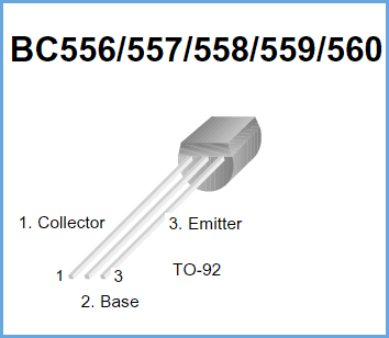

So, what was the problem? Once I got back to no PIC, no LPT situation, I started checking the potentials around the Vpp and Vdd switching transistors, as they were the most suspicious ones. By accident I measured the end of the collector resistor (680 Ohm) of Q(Vpp) transistor was connected to ground, and I read 4.95 V ???! Of course this means that this end is actually NOT connected to ground.
In addition to not having that much practical experience, I also am a rather sloppy builder and PCB designer, which is why
How about posting a picture of your programmer, so we can see what it looks like?
made me blush with shame a bit :oops: Anyways, I have included a scan (sorry for the poor quality) of the PCB. You can see that I have some very very thin tracks - the etching acid of course ate through a lot of them, so the first thing I did was to check those, and fix them with solder. As the ground line was thicker, I was not so meticulous about it - found one error there, fixed it and thought that was it.
But apparently it wasn't - so after finding these suspicious 4.95V, I checked that track again, and there was a microscopic crack in there (couldn't really see it, but I could feel it by dragging the probe lightly along the track) where the conduction stopped - so I resoldered it (the problem spot) and it started working - I could see that Data and Clock to not crossmodulated any more, and Vdd and Vpp can happily stay high at all times :) So, basically the source of the problems was a floating collector resistor of the Vpp transistor :)
