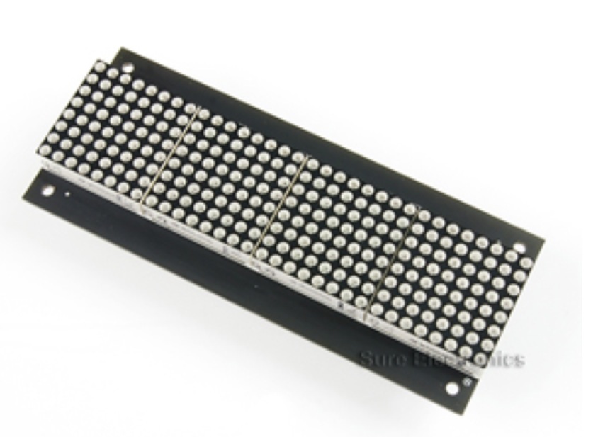

You might be better off using one of the 32x8 LED arrays from Sure Electronics on eBay for around $15. They use an HT1632C LED driver chip to handle all the busy work of multiplexing. You just send the data to be displayed over and SPI- like interface and the chip handles the rest.
Dang it I took the long way around for sure. Wish I had knowen about the HT1632C setup.

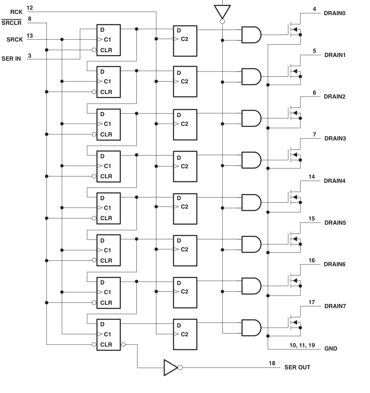

No. The TPIC6B595 has a similar function to the 74HC595 in that it's a shift register. Its outputs are designed differently for high current/ high voltage operation (from TI):
Outputs are low-side, open-drain DMOS transistors with output ratings of 50 V and 150-mA continuous sinkcurrent capability. Each output provides a 500-mA typical current limit at TC = 25°C. The current limit decreases as the junction temperature increases for additional device protection.

No. The TCIP6B595 can only sink current. No matter how you want or expect it to work, this chip can only act as a ground in the same manner as a ULN2003.
That would be the meaning of the word drain in the data sheet.
You can also see in the data sheet that the chip can only provide a ground connection on the output.

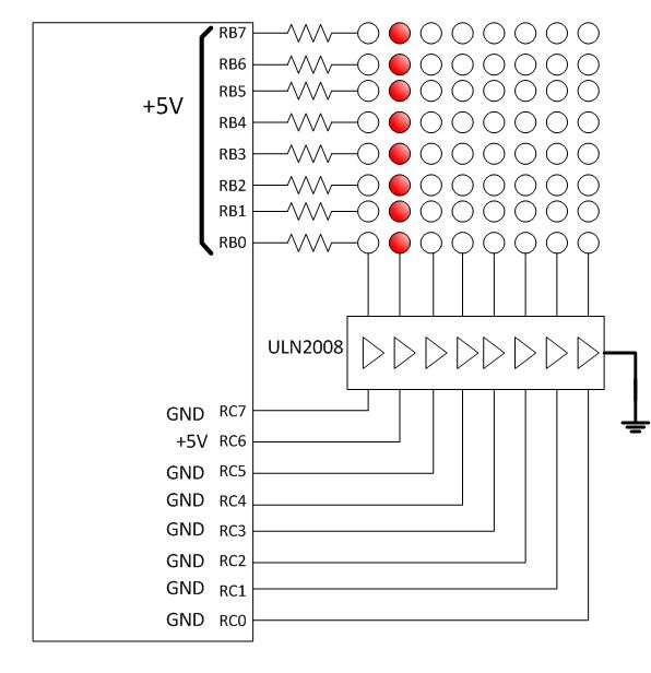

Your circuit needs to put 5 volts on the anode of the LED while the 2803 puts ground on the cathode. Your chip can not put 5 volts on the anode the way it is hooked up. You may be able to salvage your work by using the chip to turn the LED off instead of on.
I see my error. Now to see if I can salvage as per ronv's suggestion or purchase said unit Jon suggested BUT I need this up and working by August 17th if I can or else forget the project. As I stated we spent $4100 on new refrigeration equipment and I wanted to "brag" about how cold our beer is during the county fair.
Getting a componet from China takes a long time sometimes 3 weeks.
You can probably still make this work. Arrange the anodes in rows and the cathodes in columns.
Drive each row via a current limiting resistor from one pin of a port (one port used for the rows). Use the shift registers to SINK current from each column, one at a time. Only one column is illuminated at a time, so each port pin only drives one LED at any instant. Much like the illustration below, with the ULN2803 replaced by the high power shift resister.
