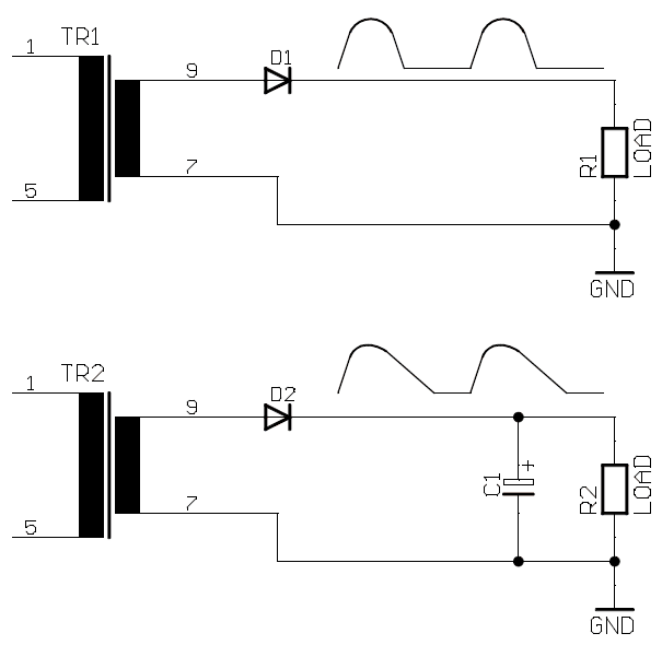

Please help to provide me a complete circuit for the Half Wave Controlled Rectifier. I have searched many times in the internet but i could not find any complete circuit wif the firing circuit to fire the SCR.
as the term "half wave" suggests you just use one half wave of the AC to rectify.
Here is a circuit of a half wave rectifier.
Boncuk

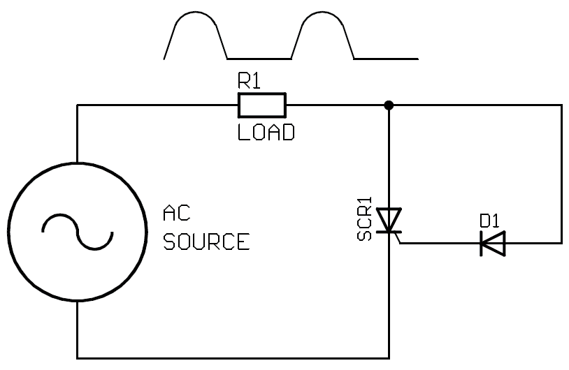

I think he means a 'controlled' rectifier, which uses SCR's instead of diodes and they are only turned on as needed by the load, and the turn on point is determined by the control circuit, which is what he seems to be looking for.
Sorry for the misunderstanding.
He probably meant something like that.
Boncuk

The SCR gate voltage isnt that accurate so you can not really depend on turning it on using the gate characteristics as the backbone for the design. Usually some sort of trigger circuit is used to fire the gate and that is what turns the SCR on. It can be a short pulse and then turn off until the next required firing of the SCR.
