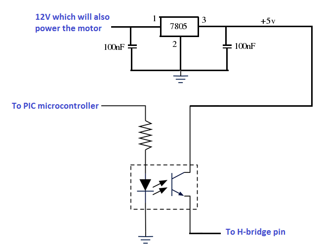

Also, is the circuit attached efficient/practical to use? I used an opto isolator to isolate the PIC and other ICs ground from the power ground. A 7805 is used to reduce the 12V (which will also be powering the motor) to 5V for the H-bridge logic pins. The H-Bridge ground will be connected with the powers ground. This way any references used with the PIC will not be effected by the motor.
You still have the same GND for both PIC and the load. noise may still be an issue. if you want to be totally isolated, use the opto couple + isolate both supplies with the component i attached in my previous post. Other wise, both circuits will still share the same GND, and it would be useless to use an opto coupler.
Also, the transistor in the mosfet is not wired optimally to be in saturation mode, you may want to read my tutorial below:
The load need to be connected to the collector, and the emitter tied to GND, otherwise, the transistor will never saturate :)
