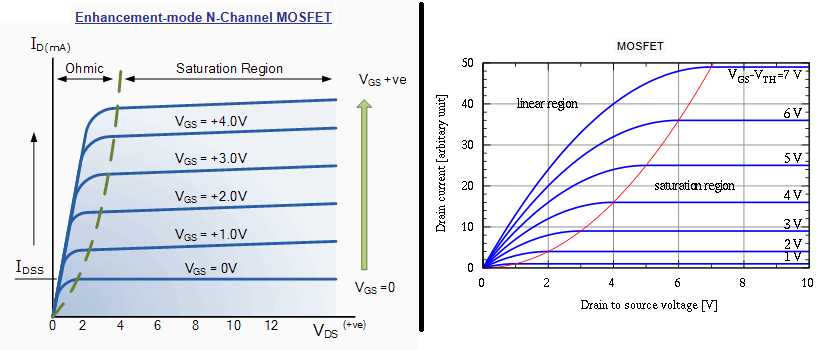

Mosfet operation is the opposite to bipolar transistor operation.
A Mosfet is in the "saturation" region when it is not turned on hard. It is in the "ohmic" or "linear" region when it is turned on hard.
Thanks for answering, but one of you says one thing and one the other.:) But AG's graph shows the opposite of what he verbally says, but reinforces what Eric says. Now which is it?
No.
My graphs show that the Mosfet is a linear amplifier when it is in the "saturation" region and it is a switch when it is in the "ohmic or linear" region.
A Bipolar transistor is the opposite.
It heats when it is not switched on hard because then it has voltage and current. When it is switched on hard it has current but its voltage is very low so it does not heat much.

Yes, I meant to say that. AG has already posted the graph of the MOSFET operating regions, which clearly show that in the linear/ohmic region, there is less power dissipated by the MOSFET.
Nothing reinforces what Eric said. Eric misspoke. AG was consistent with the graph.
To work out the power dissipated by the MOSFET from the graph, for a given trace, simply multiply the voltage by the current for each point on the trace. From this you can see where a suitable operating point (or region) will be.

OK, I know I'm not near as informed on this stuff as the rest of you. But the graphs that AG posted and the link that jpanhalt (jp) gave still don't make sense to me.
All of the graphs in mosfet data sheets are basically the same. The ohmic/linear region is at the left side and a very small part of the scale. In the link from jp it gives an example of a mosfet that has a 30V rating but the ohmic/linear region stops at ~1.5V, and then goes into the saturated region. It , the example given in the link, is a logic level mosfet and this 1.5V is where the curve starts on the graph for Vgs 4.5V the rated value.
What am I missing? How is the graph supposed to be read? Surely the ohmic/linear/useful voltage of a mosfet isn't that small?
In many electronic websites the thing they always say is turn on the mosfet fast and hard, to get it out of the linear region as fast as you can. Are they all wrong?

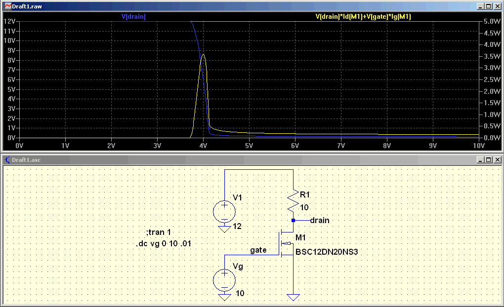

Does this help? It shows FET dissipation as the gate voltage is ramped up from 0 to 10V. I don't recall seeing the max power region referred to as the 'saturation' region.
