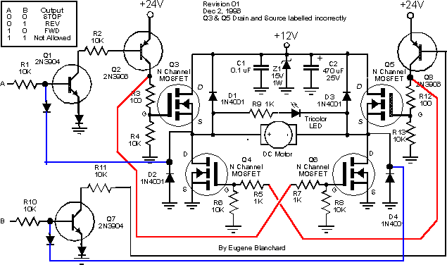

I have modified the circuit a bit hoping for some improvement. The both "1" state is still "not allowed" but if any control signal is already "1", the going high of another would have no effect until the corresponding channel control signal returns to LOW. This would help a little bit.

Still got SHITE gate-drive (will cause a soft shoot-through)
and that LED still exist which will fail the moment the potential switches
Proper gate drive is only needed if the OP wants to use PWM for speed control. For just forward/reverse action, the design is sufficient in a hobby sense.
It's a tri-colour, so is two LED's back to back.
Thats answers that, correct symbol would be handy tho
There will alway be a big difference between driving MOSFETs in industrial situation and in hobby circuit.
For just fwd/rev fixed speed (based on link potential) yes it is fine BUT if it is to be PWM'ed (and that doesn't have to be industrial, there are plenty of places where hobby PWM is used) this cct will FAIL

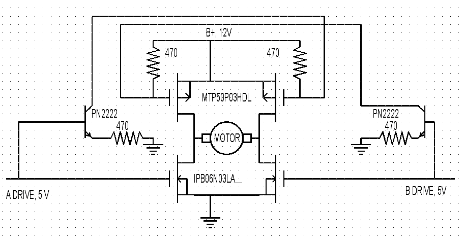

The IRFZ48n is not a logic level mosfet, so if you are driving from logic, it won't turn on reliably. The transistors I chose are logic level. The NPN driver is designed not to saturate, to avoid that delay. Even so, efficiency will be improved if you provide some small delay between turn on and turn off of A and B drives.

You are of course 100% correct regarding proper gate drive under PWM condition. In fact I have also advised others to do the same with proper gate drive.
My modification to the circuit is just done as an exercise to make it safer without adding extra cost(except four diodes). The original circuit is fundamentally faulted and bad design as you had already pointed out in another post.

RUSSLK circuit is very simple and efficient circuit ... as i think.. but the problem is with the parts.. as i live in pakistan so i cannot get those transistors from local market..
would u tell me that if i use the mosfet IRF4905 with IRFZ48N and make a bridge circuit like RUSSLK's and us the power BJT TIP122 to switch on the PMOS power mosfets on the upper side ..
will it solve the problem or the dc to dc converter with IRFZ48N at the upper side is the answer..or some other solution
