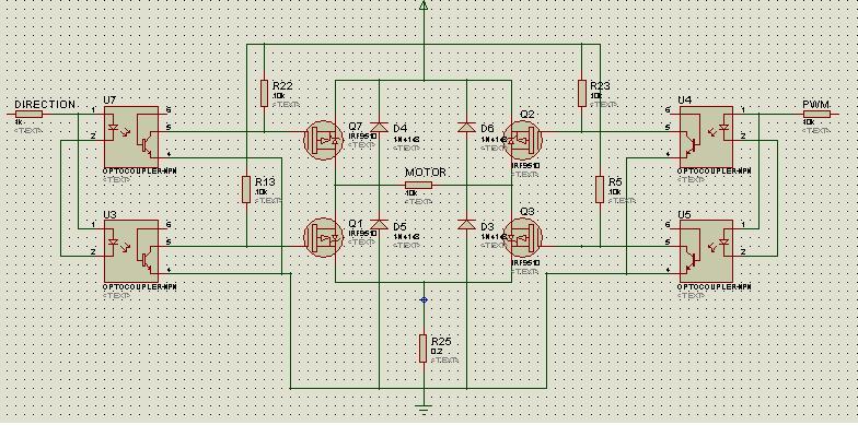

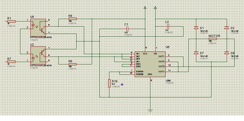

here's the circuit. for the mosfet driver, the lower mosfet is irfz34. one things different between the schematic and my test circuit is that i did not have diodes. i'll include it in future. DIRECTION is set to PIC normal pin(set either high or low) and PWM is set to PIC PWM pin.

You forgot to tell us the frequency of your PWM.
Since you don't use a Mosfet driver IC then the 10k turn-on and 10k turn-off resistors will take a long time to charge the high gate capacitance of the Mosfets.
one thing about l298. when i remove optopcoupler and directly connect DIRECTION and PWM to the pic, it solve sensitivity problem. is this safe because there is no isolation between the motor and control circuit.
Your schematic does not show the supply voltages so we don't know why you have opto-isolation. Is there enough gate voltage to fully-turn on the Mosfets?
You have the PWM input with a 10k current-limiting resistor that has a value much too high so the LED currents are much too low. The Direction resistor is 1k which is better but it is still too high.
You have the LEDs without a ground connection so they do nothing.
You have the LEDs in parallel so only one might conduct and the other one won't. Each LED should have its own current-limiting resistor.
One cycle at 10kHz is 100us. If each LED has a current of 10mA then the opto switches on in 2us and switches off in 2us which is pretty good. You had their current extremely low so they switched very slowly and the Mosfets were ramping instead of switching.
I think the 10k resistors have a value that is much too high to quicklyturn off the Mosfets due to their high input capacitance. But the opto-isolators might not be strong enough to drive a lower resistor value. Try 1k ohms.

I forgot to include GND in the schematic. The pic side is 5V. Motor side is 20V. I'll try your suggestion and get back to you asap.
I have tested your suggestion but it's negative. what is the typical temperature for mosfet? the mosfet is way too hot to be touched. mosfet has operating temperature up to 175 celcius. for human, >60 celcius is considered not touchable.
Maybe both Mosfets are turned on at the same time with a very high current through them.

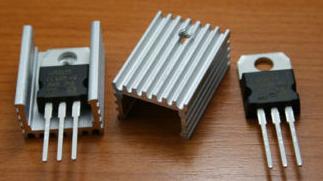

You mention height, depth and width but what about length? It would be nice if you can provide me with an illustration(or link) that contrast will the actual mosfet size. thank
My heatsink was similar to the little one posted here except mine was anodized black.
It is good for about 3W.
If I read your circuit correctly, then the problem is: You are turning on the high side and the low side on ONE side of the H-bridge at the same time by the PWM-signal, and this gives you something near a short circuit (only near, because the MOSFETs have an internal drain-source resistance) you need to turn opposite sides on, not the same side.
