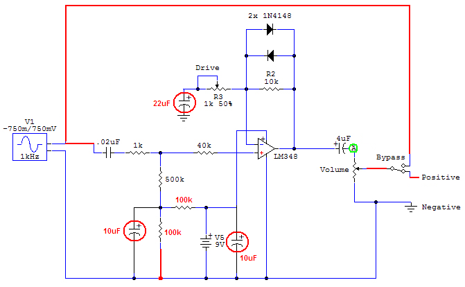

Ok heres the dilemna. Ive never made anything electrical in my life but I have been reading heavily about amplification and how to distort sine waves in the past few weeks (I know the basic electrical principles as well.)
Anyway i need to make a distortion/overdrive pedal for guitar for this Thursday coming.
So here is what I have so far:
(The signal gen is the guitar input and the ground on the right is where the output will be.

Who needs an expensive valve amp when a cheap circuit like this will add all the distortion you need?
Use a potential divider to get the 4.5V.
I thought the potentiometers and volume controls were used to alter the clipping and output voltage.
Ok thanks the voltage divider thing worked great...haven't solved any other problems though.... (and Ill probably end up ditching the 2nd channel unless I get that to work.)
Can anyone tell me why Im getting clipping like this on the above circuit and not on the bottom of the wave?
The bottom of the waveform isn't clipped because the top diode in your schematic is broken or is connected backwards.

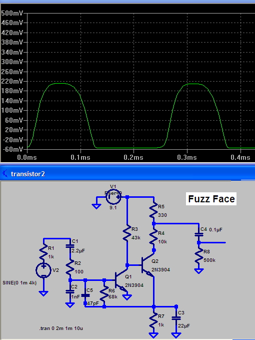

I simulated the Fuzz Face circuit used by Jimi Hendrix. It is something like yours:

well I changed the direction of the diodes and it does absolutely nothing.
What I can do though is place a variable resistor with a max resistance of 15k on the V- End of the opamp...and that clips the bottom. then I can adjust the top with the drive resistor.
I dont think that those diodes are even being used.
The top diode in your schematic must be replaced because it isn't conducting. Your 'scope shows the bottom diode conducting normally when its signal voltage reaches 600mV.

The top diode never conducts because it is always reverse biased. Try connecting the 0V end of R3 to 4.5V.

No R3.......
TrevorP said:
-How would I go about making it so that the top diode conducts as well? Because no matter what Ive tried I just cant get it to clip the bottom also.
I have fixed your circuit. It was a bad mixture of a single supply and a dual polarity supply.

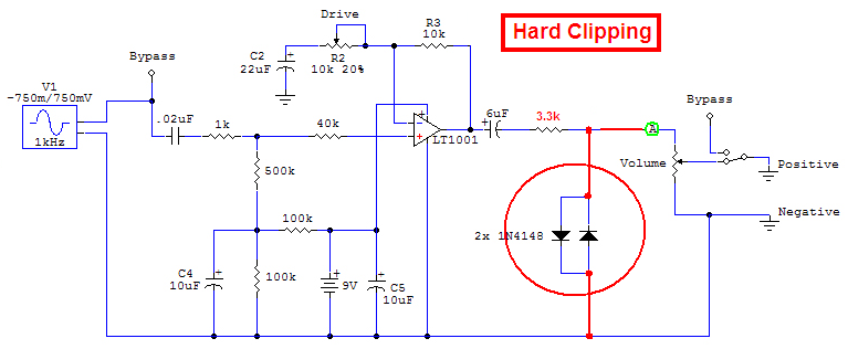

You've got FAR too little gain, increase the feedback resistor to 220K or 470K, get some clipping going on!.
The diodes in the feedback loop of an opamp creates "soft clipping". If you want nasty, acid-rock "hard clipping" then try it this way:
yes that thing Audioguru...wow it worked this time...weird.
