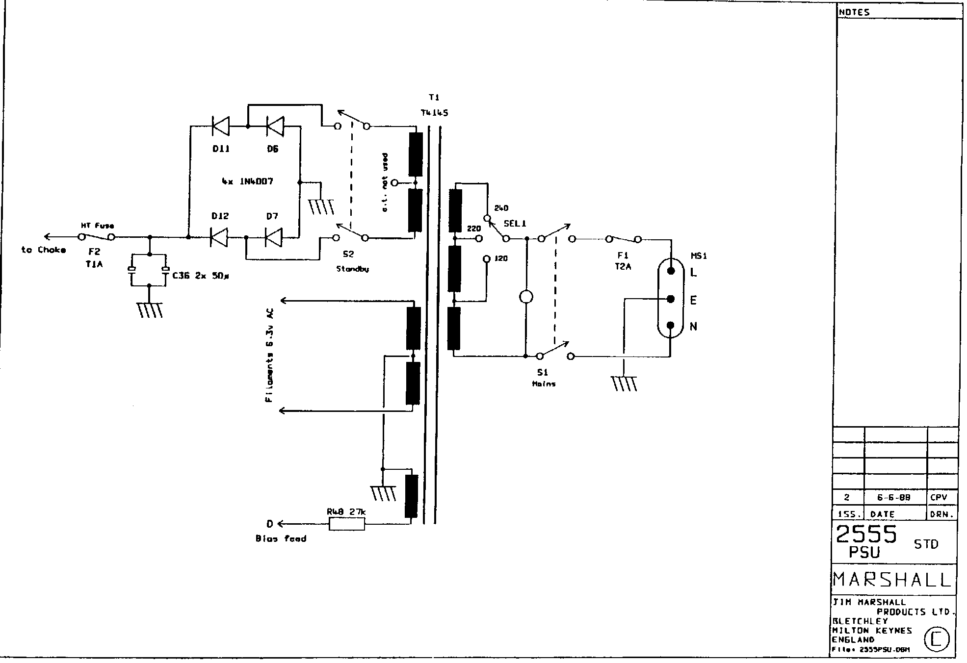

Well I'm about to get my income check back and was thinking about buying a new tube amp but I've also been wanting to get back into the electronics hobby and so I had an idea at about 2 this morning to design my own amp and learn more about them. While researching in google I came across the schematics to a Marshall 2555 Jubilee which is the amp I was going to buy two years ago but got screwed on my income tax return and ended up having to pay money instead of getting anything back. This is an amp from 1988 and when you find one they're usually about $2-3000 for the amp. I haven't had that kind of money in a long time, I was planning on spending $400 on a cheap tube amp but after looking at these schematics it isn't really that complex of an amp so I'm going to try building one (mainly because I would love a jubilee).
Anyway I don't have much experience with audio electronics (besides turning my amp on and adjusting the knobs) but I think I can do it. I need some help though so I figured I would ask the experts here. I'll also try to document the project as I do it so that anyone else interested in building this amp can look at it.
So these are the psu and the main board for the amp.
My first problem I've run into is I can't figure out where the psu attaches to the rest of the board I've got the psu figured out and already have most of the parts for it in my scrap bin and am going to get started on it this weekend then I plan on tackling the beast that is the main board. Question 2 just thought of would I want to use 1/4w, 1/2w or what for the resistors in the psu? I've never built any project that called for more than a 1/8w resistor so I figured I'd ask..

hmmm well the vacuum tube comment I assume since there are still amps like this around that there is either some similar tubes that would work or that someone was still producing those tubes. There are companies that still produce tubes just for guitar amps. As for the transformer I looked up the manufacturer for the transformer and I figure I'll give them a call or something.... I'm not 100% about everything yet, I've been swamped with tests and school recently so I haven't had much time to research it but I just thought of those two questions and thought I would ask. I figured out the schematic question and also found out that there is a company producing kits for this particular amp so I'm guessing there is quite a good chance that parts are still being made.

That's a heck of a lot of parts to wire together. If you don't have a pcb for that it's going to be a really long project. I would suggest you contact that company producing the kits a get a pcb from them if you can, also some of the parts like the output transformer and the tubes.
Found the output transformer and the power transformer. There is replacements being made for marshall amps and they have both the 100W transformers the output is $99 and the power is $109

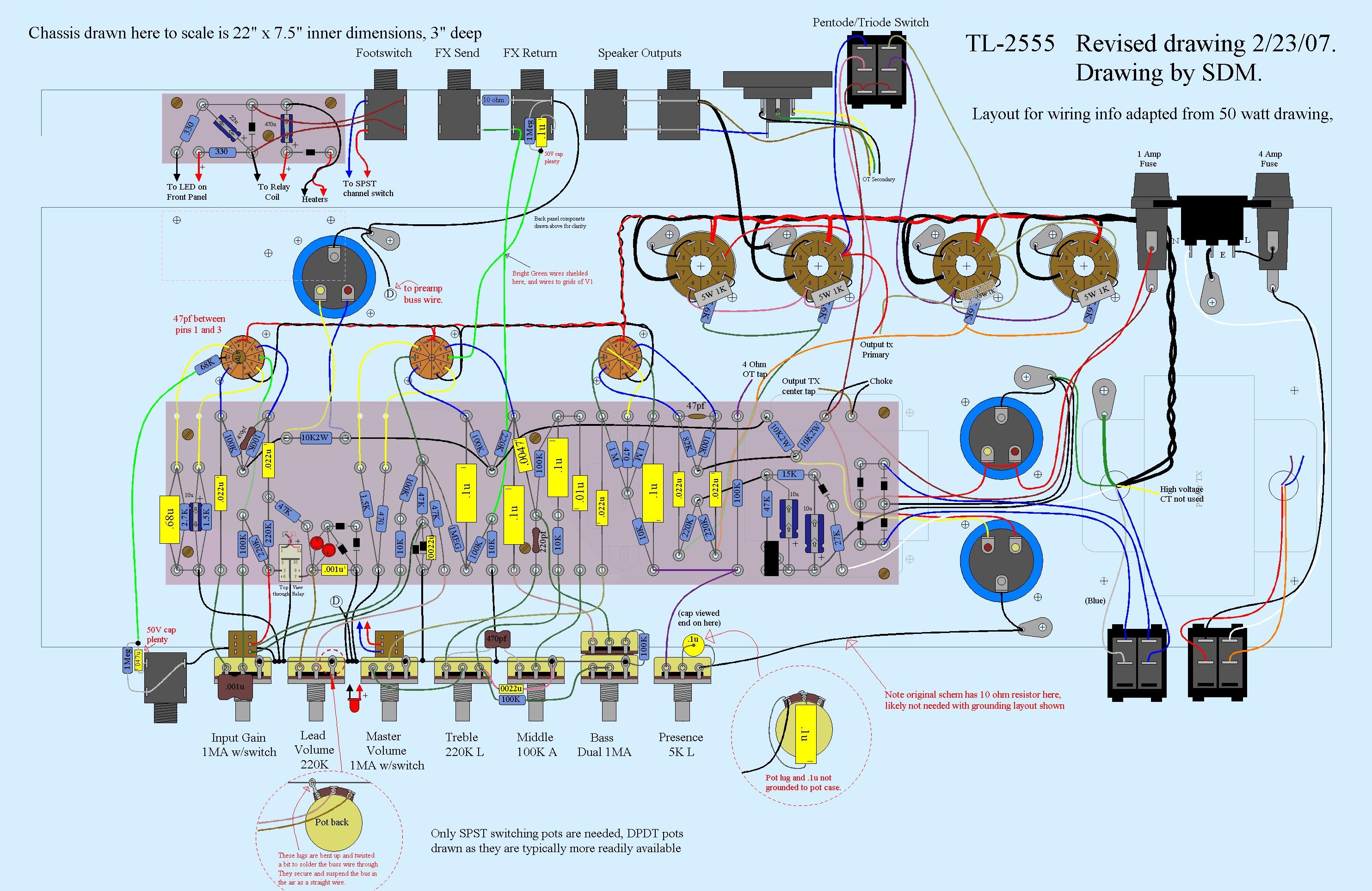

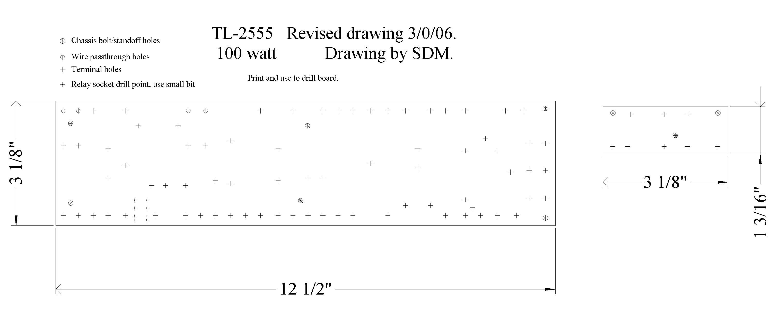

I don't think the wiring should be all that difficult, I would etch a pcb for it but if you look at high end amps they aren't done that way. "Hand wired" amps are what they do with high end amps (some crap about them being better) and it's just a board with wires run between the components.

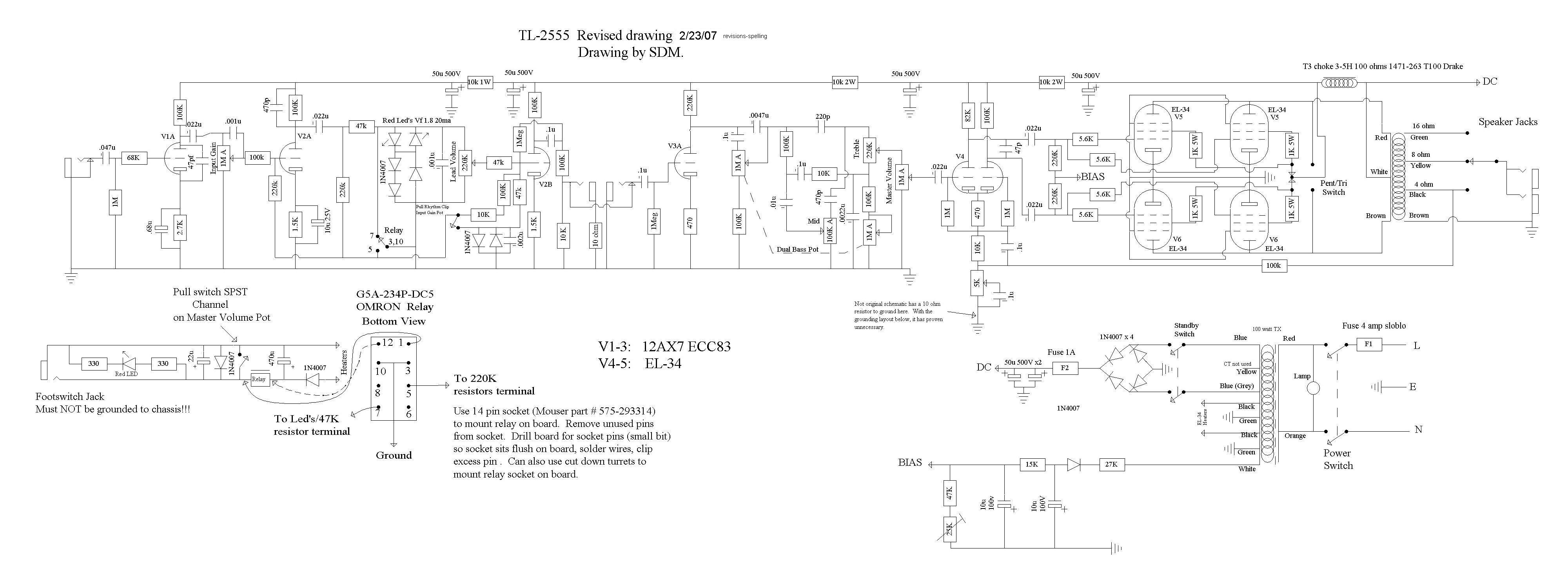

I also found more clear circuit diagrams and even a wiring diagram and a placement board for the amp, though the 120, 220, 240 selector switch is omitted but thats not a big deal to me plus it can be added really easily though I will only use the 120.

before you start go visit Hoffman Amplifiers, Tube amplifier parts, tube amps, tubes this is about the best resource for tube amps out there. From parts (transformers, tubes, sockets etc etc.) to forums to to schematics to excellent advice and FAQ's. You may even want to change the amp you will be making.

Don't be fooled by the wiring, this is the most critical part of tube amps, failing to follow convention will result in hum and crosstalk and other nasty things.
Oh forgot to mention, the voltages are very high and really Biiiite.
Please go visit hoffman amps before you start ........ you will save yourself time and frustration later.
