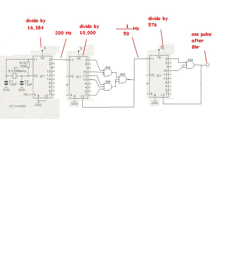

you have to use a high frequency crystal oscilator and a divider if you want to get good accuracy. i remmeber i have posted a diagram long before for some timer for LED control, that gives 1 sec pulse, this can be fed to a divider to get 8 hr, then after 8 hr count it can set the reset of counter via another counter that will enable the reset after 16hr (8hrx2) count. then it will reset after 8hr. if you need complete circuit i can post shortly.
see the attached time base, hope it will give a single pule after every 8hrs, if any one can simulate it? also hee needs 8 hr then 16 hr signals, so the out put can be fed to a 4017 and to some logics to work as required.
Edit: .made a mistake connect U1A to pins 13 & 6 of last IC, resets can be done using the free pin(now connected together) of AND gate inputs for last two steps and the 1st ICs direct input.

I don't see why you should need to simulate it, if your logic is right then it should work.
I have two concerns:
There are no decoupling capacitors, there should be a 100nF capacitor across the supply pins of each IC.
What's the supply voltage?
The CD4060 might have a problem counting 3.768MHz if the supply voltage is too low.
