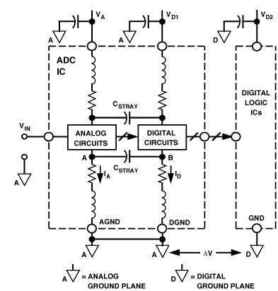

See image.
See this article. Analog Devices: Analog Dialogue: Ask The Applications Engineer - 12
it is not always necesary to separate the grounds. it is actually better to have a solid ground plane as long as you can route noisy stuff such that they are away from the sensative analog stuff.
