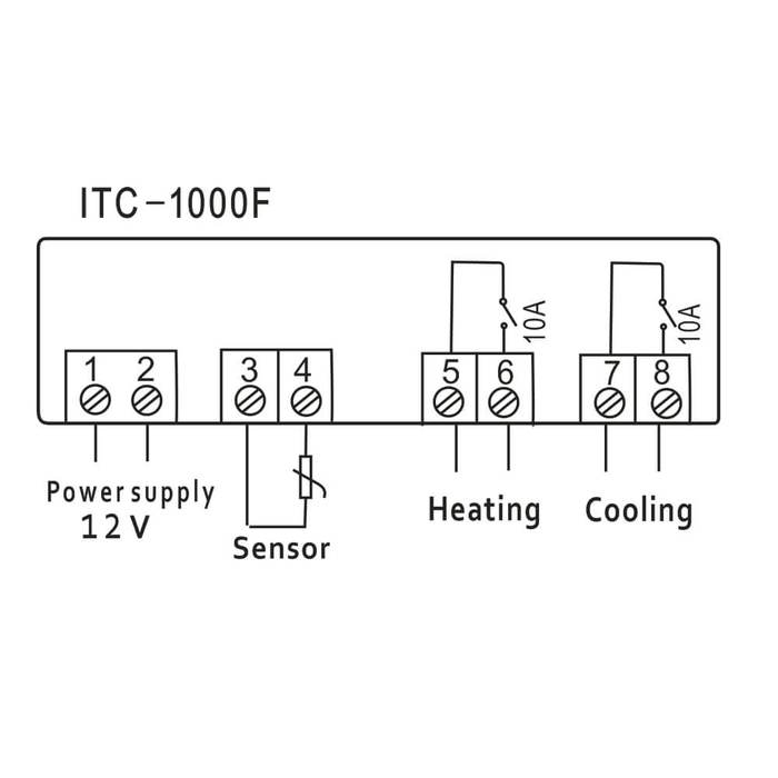

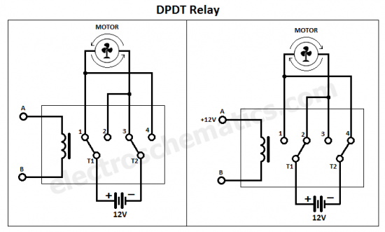

I am trying to create a greenhouse door opening system,using an 12VDC temperature controller thermocouple,and an 10 inch 12VDC linear actuator.
As far as I know,I will have to reverse the polarity to be able to retract the actuator,and this is where I don`t know how to do it.
I will atach the schematics of the thermocouple,maybe youguys can shed some light here!
Thanks!

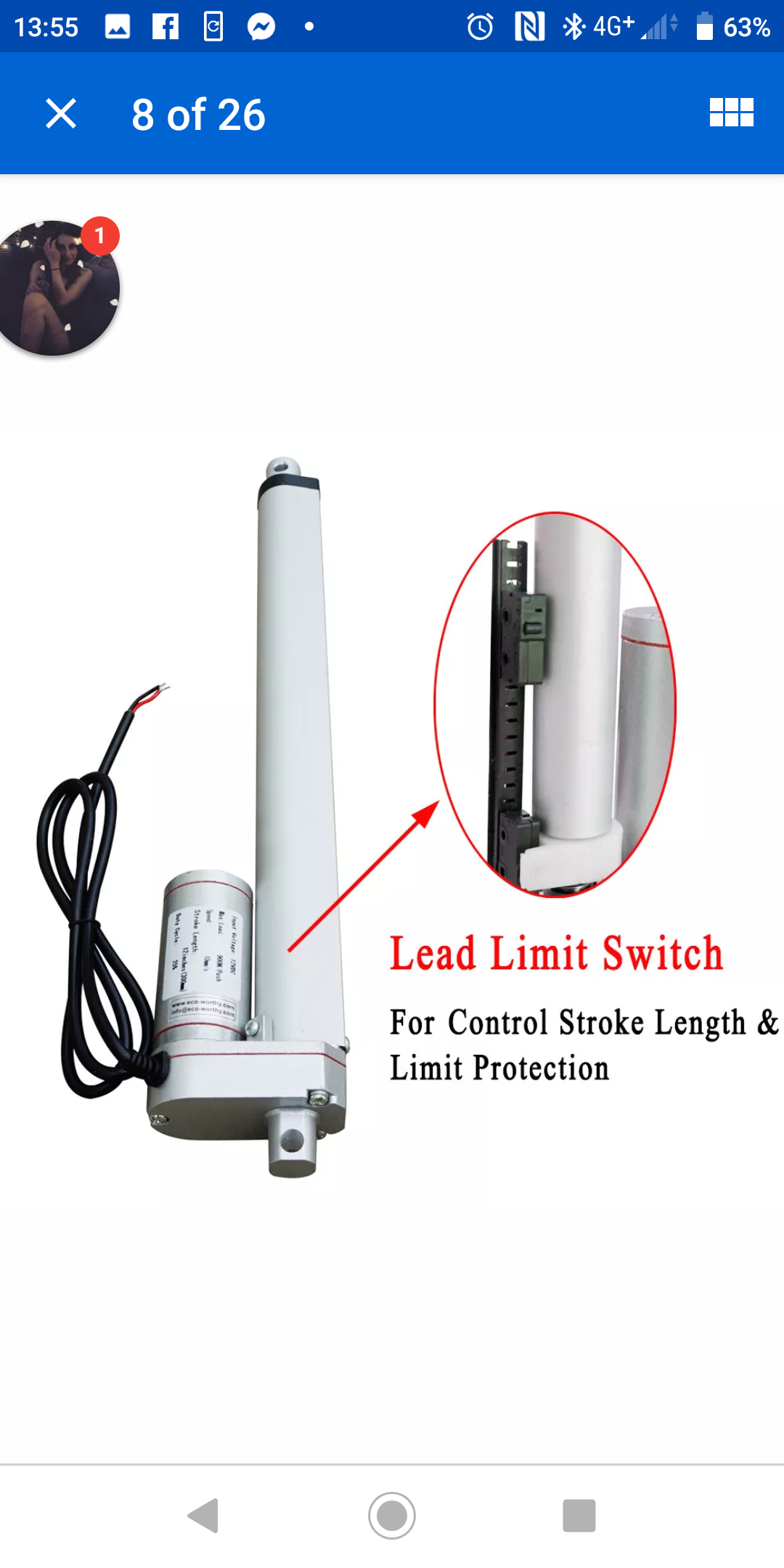

I have two types. One type I need to remove the power when the actuator hits the end. The other type has a switch on each end to stop the motor and cut the power.

The actuator is a 2 wire,with end switches,from Ebay!
So a two wire, you must have to reverse the voltage to reverse the direction. OK. I need to think.

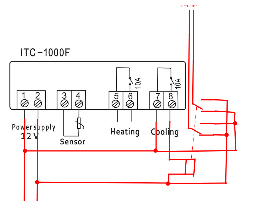

12V powers the 1000F. The cooling switch (7-8) sends power to a relay. (DPDT type). The relay sends power to the actuator. When "cooling" is open no power goes to the relay coil but when "cooling" closes the relay coil gets power and switches the relay. The relay reverses the voltage on the actuator.

A picture from google that does the same thing. (different wiring but the same effect)
118406
118407
I'm surprised at you guys. it's just a modification of the "chicken coop door" problem. or "door lock actuators".

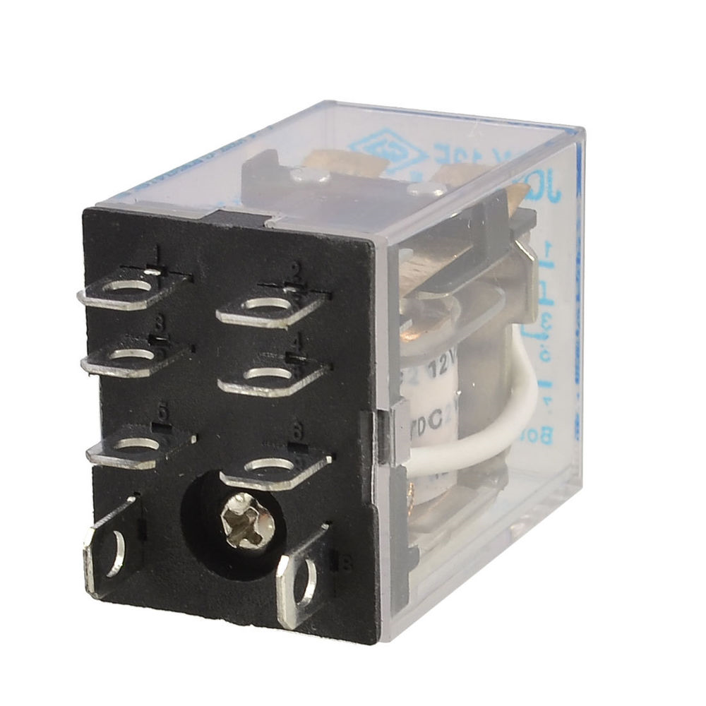

the "door lock actuator" wiring does provide dynamic braking, so no overuns. You can start with two DPDT Automotive relays. You can buy a dual relay harness that has some of the interwiring of the relays done for you.
It start's here: **broken link removed**
The relay terminals should face down. Grrenhouse: automotive relays, I think is better choice.
In any event, the common terminals of both relays go to the motor and the NC terminals of both relays go to ground. The NO terminals goto +12.
You activate one relay for up and the other for down. If they are both off, then the motor also brakes.
You can use cool to activate one relay (open the door) and the other heat (close the door). That, I think makes sense.
You may want diodes across the relay coil reverse, e.g. 1n4002. This protects other electronics when the relays switch off.
If this is a battery application, you may wish to install your own limit switches. To install your own limit switches, the contact rating of the limit switches must handle the automotive relay coil current which is about 150 mA give or take.
To add an up limit switch, just put it in series with the up command relay. When the door reaches the UP limit, the switch opens. Vice versa for down.
These relays would then not be activated when the door is at a limit, saving power.
I mixed up up/down and cool/heat or open/closed. Take your pick.

I THINK that the internal actuators limit switches are probably designed more for actuator protection and I think overrun is possible.

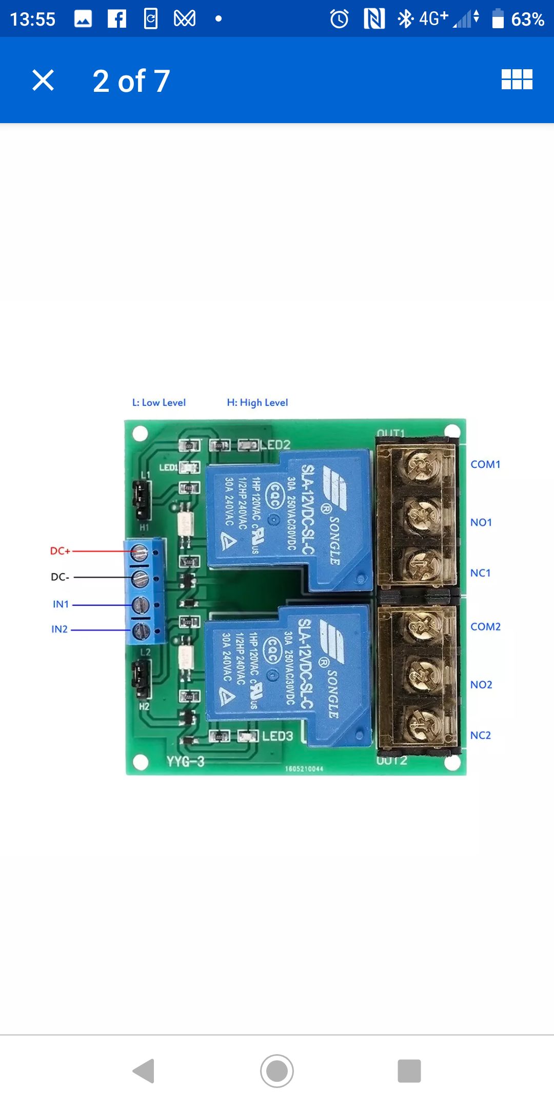

This is what I am planning to use,the whole setup will be powered by an 12VDC 10A power suply,no battery yet.
