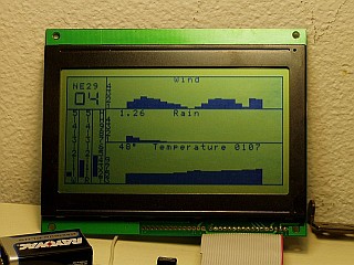

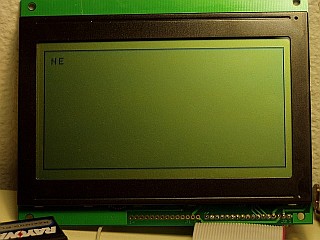

Per request here is a bare bones program using the 16F628 to drive a
graphics LCD.
The init routines are specific to each LCD.
PICLCD.jpg is what one should see when the program (PICLCD)and the LCD are communicating.
PICLCD.txt is ASM.
Myproj.jpg is what I have been working on.
Hope this helps.

I have a project based on that exact SED1330 controlled module.
Did you know there's a halftone available on that part? You just need to set up the pages right.
It kinda sucks that it flickers every time a write or read goes across the LCD bus. If you write or even read too often the display goes to crap. T6963C doesn't seem to have this problem.
Yes, thanks.
I am still developing the project and will begin to cleanup the display
after I finish the logic.
Some thoughts on the blink problem.
In my application I wait for a data packet from the transmitter and
write to the display whenever that occurs.
I am writing 268 characters at a time and have not seen a blink.
You do not have to issue a MWRITE for each character to be written.
In the file I posted is the method used to write data to the display.
I remember reading in the specs that a timing bit can be checked and the write issued when that bit is in the required state.
I would think that would only be necessary if you are hitting it on every LCD cycle.
I am running the PIC at 4MHZ. That is the approx timing of the display.
Hope this helps.
