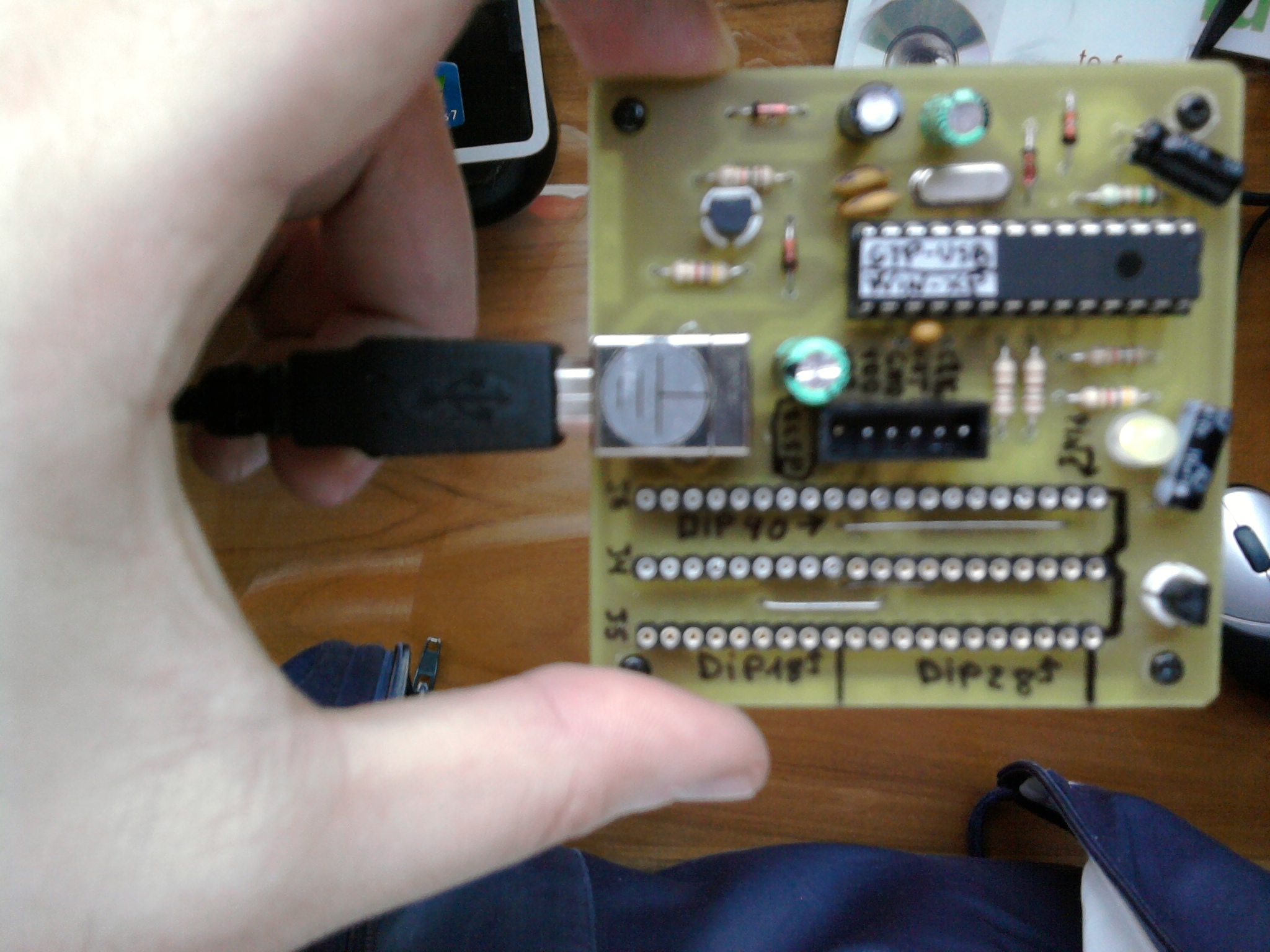

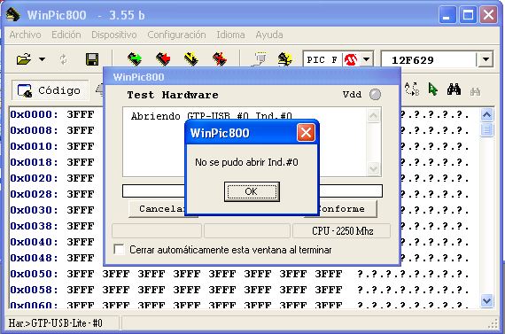

Hi!Thanks for the aids, well... I´m on similar situation but i can´t figure this out, the XP mode really works in Win 7 with "todopic usb summer 2005 pic programmer" The light swapped to green color in my programmer, so driver works well, but when I go to "Winpic800 ver 3.55b" and click "Hardware Test" it says "Failed to open Ind.#0"= "No se pudo abrir Ind.#0"

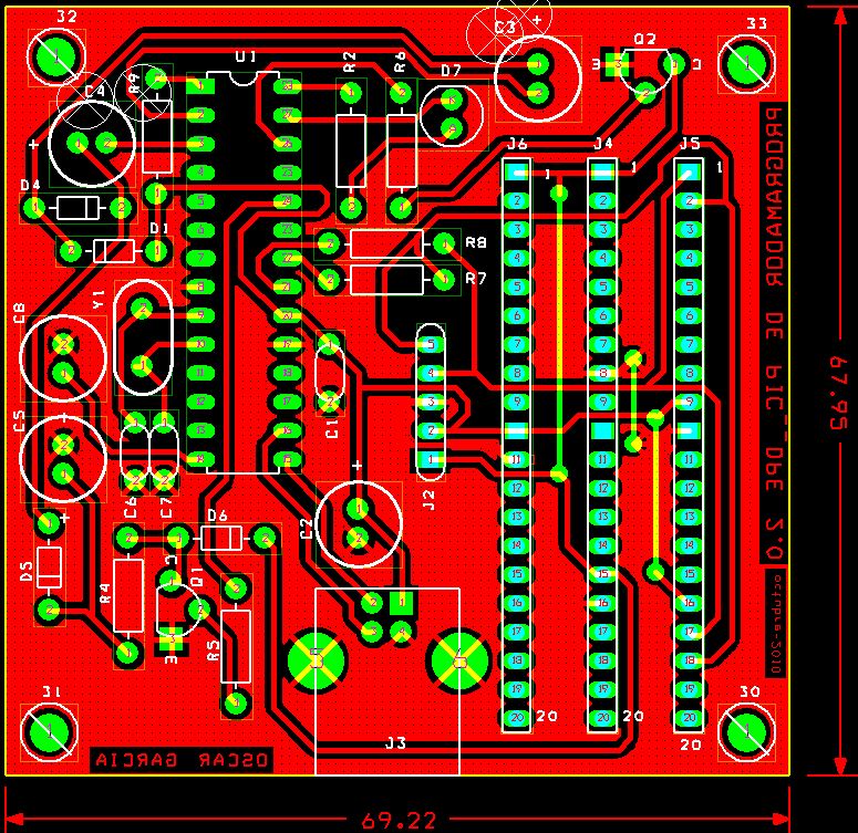

What´s the problem? I have this programmer as a homework of my teacher and after making a good design and assembling it´s a pity just throw it to the trash, you know!
Thank you in advance guys!

yeah i had the same problem.. after some hunting on the internet it appeared to be something wrong with the power supply of the usb.. are you using an acer laptop by any chance? i couldnt find a solution.. id very much appreciate it if anyone does have a solution :)
As you can see I have a Dell laptop and I checked the usb supply in my pcb, there is no problem! i got 5 volts, that´s it! The 13.5 volts only appear when you are programing, so What´s wrong with the power? Please, let me know what you found on the internet,.......and yeah man, please, has anyone a solution? Thanks
