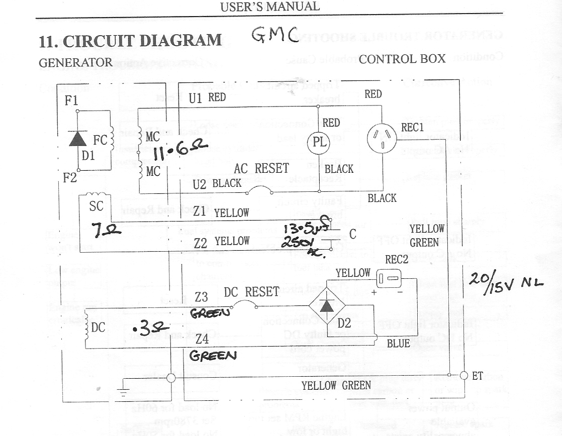

One more thing.I know this might sound stupid but I noticed that this small portable 650w generators do not have voltage regulation like the standard bigger types and so I was wondering if it was possible to construct a circuit to attach to the geneartor output that would maintain constant voltage whether load is plugged in or removed.we then take the output from the circuit into the household.

If you are refering to the 650W 2stroke generators, then this is the circuit. The voltage is fixed by the size/value of the capacitor 13.5Uf 250V. If you alter this capacitor you alter the voltage. Engine RPM also alters the freq & the voltage , but should be set at the freq you require 50/60 Hz. These generators are notorious for exess voltage if you let them run out of fuel with a load on them as the engine rpm varies a lot. I do use one but im careful how I use it.

One mor thing, I see that this small 2 stroke gennys come with I think 12uf/350vac caps(I think) but what some locals do is replace that with a 24uf or even 30uf cap and they say this helps to boost output.
I read caps play a big part in this gennys but a won't mind a clearer explanation on the their role.
