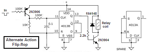

Well I've gotten bck into electronics recently after not really messing with them in about 4 years and I've got a project going but I kinda want someone else to verify that my idea will work before I go hardcore building it. Now onto the project. I'm wanting to make an IR switch for my lights in my room, that being said my plan was I've got this IR Detector Module that I got in a grab bag at radioshack when they were selling off their inventory, its a GP1U52X Infarared Reciever/Demodulator its got 3 pins Vout, Vcc, and GND. would this work the same way as a transistor basically? my plan was to wire that (if it worked like a transistor where when it got ir signal it opened the way up) to a relay where the light switch is. Thebasic idea being the ir reciever completes the circuit when it recieves ir signal then activating the relay and flipping the switch. Can anyone verify that this ir reciever works like I am thinking? IR is confusing me but I'm trying to figure it out. Thanks for any replies and sorry you had to read all that.

For simple on and off control, the IR receiver could trigger a flip-flop IC. Push the transmitter button and the light turns on. Push the button again and the light turns off. The flip-flop drives a transistor that drives the relay.

A CD4013 is a dual D flip-flop IC. It needs a positive-going clock input for its output to toggle, but your IR receiver's output might be negative-going so a transistor should be used as an inverter in between them.

ok well I got the circuit part way done, that is I can turn the light on by remote but I can't figure out how to wire the 4013 IC to "loop" so that it keeps the relay on or off. Can anyone give me some hints or describe how I should go about using that? Thanks

If the output of your IR receiver goes low when it receives IR like newer ones, and if it has the same power supply voltage as the CD4013 flip-flop IC, then this circuit might work:

Thank you audioguru this is exactly what I needed. I was trying to figure out how to wire one by looking at several schematics for IR switches but I couldn't really figure out the 4013 wireing for all the other stuff that I didn't care about. Thanks. I'm planning to redo this circuit when I have some microcontrollers and a programmer but I haven't had time to order one since today was payday I will get on that though but I just wanted to build this circuit with IC's and discreet components because thats what I have at my immediate disposal. I don't have the convenience of having a local place to get electronics, sure we have a radioshack but thats basically a glorified cell phone store that happens to have a few LED's. So I'm having to get everything through mail order. But I should have a STK500 in the mail to me by monday. Thanks for everything
