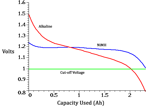

Drive them with a pack of modern eneloop batteries instead of costly alkalines(would anyone use disposable batteries anymore?) for ever.

The Sanyo Ni-MH rechargeable cells are 1.25V each. Four make only 5V instead of 6V so the power from the little amplifier ICs will be lower.
I use alkaline AA cells in the radio transmitter for my electric RC airplanes because they last for a very long time and do not suddenly stop.
I use Ni-MH cells in the charger for my electric RC airplanes.

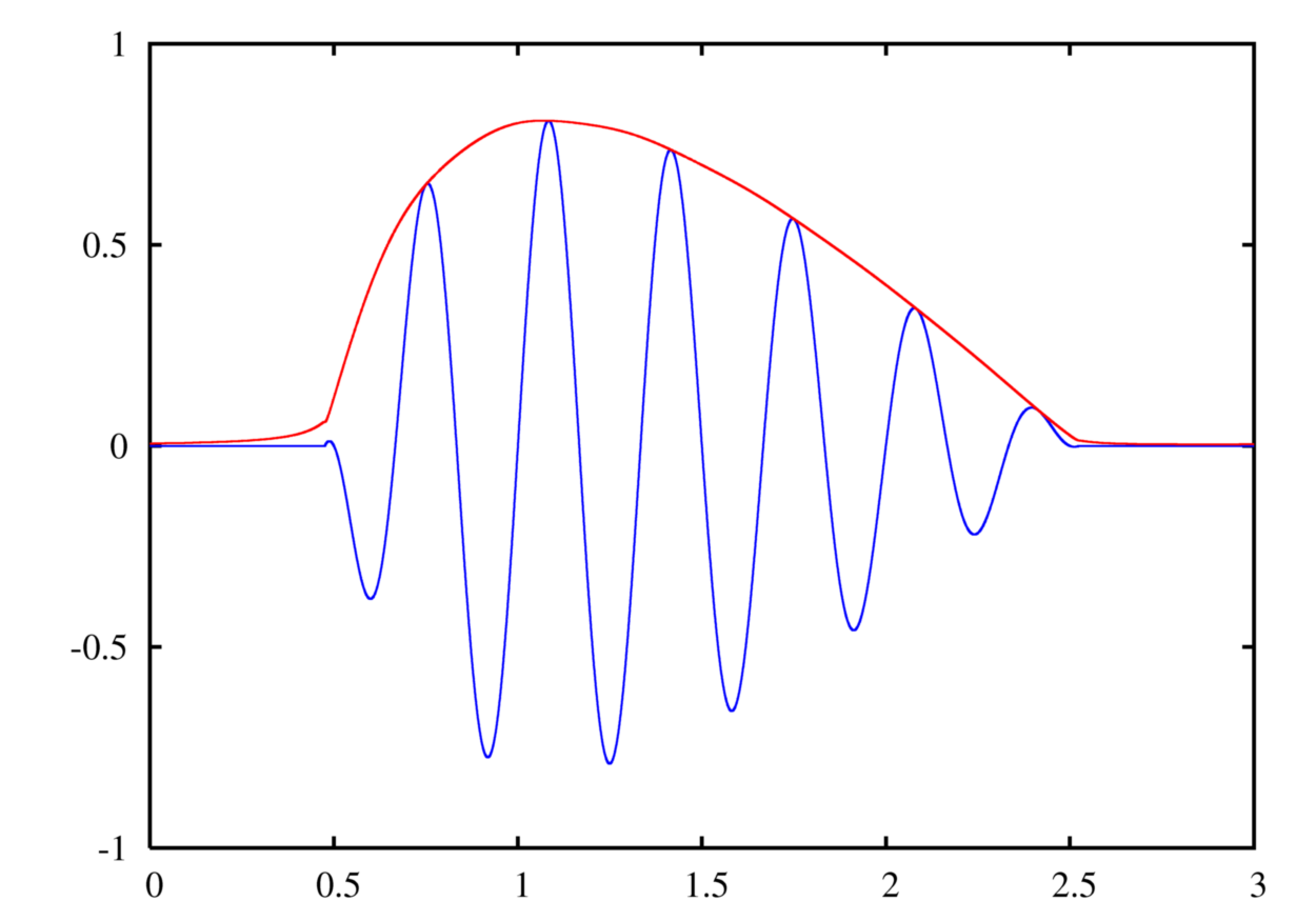

This is what the audio trace from an iPod looks like;
it has a carrier frequency of about 100Hz combined with the actual audio signal.
But voltage level of a disposable battery goes down quickly during operation(see the 9v pp3 battery- its 1/2USD here losses its voltage so quickly that needs immediate replacement), but I agree that alkaline cells got a high capacity that helps it for keeping a high voltage level. But considering consistent 1.2v of a Ni-MH is rather impressive and all in all which is good?
Normally voltage dependent loads(eg, torch) are packed with 5x1.2v rechargeable battery that is much cost effective.
Sanyo eneloop batteries are claimed to be designed for over 1500 recharge cycles.
