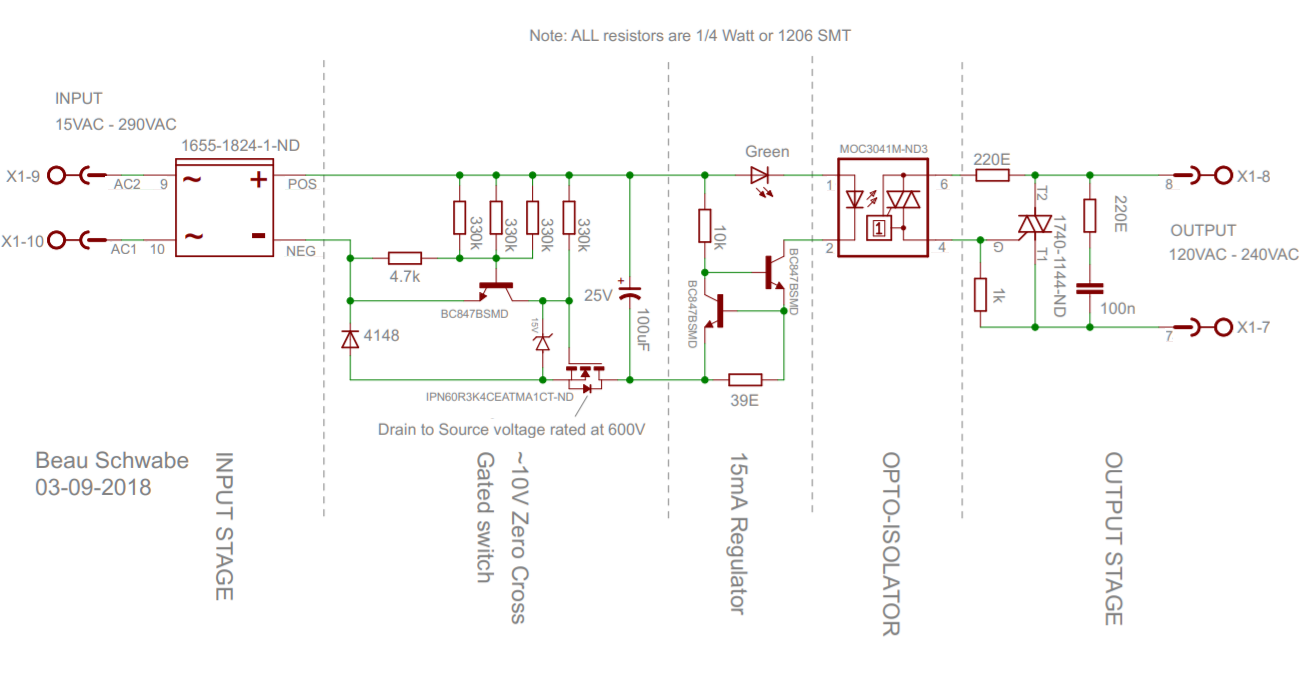

As promised, here is my schematic. It's no fun though when only one other person posts a schematic. Thanks tcmtech for being a sport.
  • Solid State Relay.pdf

Half a dozen of one, and six of the other? ... Seriously you guys are nitpicking over the orientation of the schematic? That's pretty sad actually. And I thought I would have people tearing apart the design itself.... Suppose that is next. :)
Its basic level professional courtesy. Rather like using a written and or spoken language properly. If you can't be bothered to learn and use the language property the odds are you weren't bothered enough to learn anything else relating that which you speak of either properly.
Why use three 330 K resistors in parallel rather than one 110K? Presentation wise it gives the impression that you have poor circuit drawing and or working knowledge of the concepts in play. Same with having an overly complicated process to do a simple job and function.
A good part of one's perceived credibility is in their presentation. Bad presentation gives a strong image of bad performance, skill,and overall credibility.
... Because this board was done using SMT components... at 290V the Wattage through each of those resistors is right at 250mW which is the limit for 1/4 watt resistors. Using a single 110 K resistor or 100 K resistor would have required a 3/4 Watt resistor which is more heat than I want to dissipate in a single component. There is good reason why this circuit was designed the way it was.
I've been in the profession for more than 35 years and honestly I don't see an issue with the original schematic, you just rotated the schematic 180 Deg, and then the text again by 180 Deg.... So the TEXT was fine then since it is back where it started essentially? <smirk> ... Perhaps I am dyslexic and that would explain everything. This reminds me of a place I used to work about 25 years ago. One of the tests was to have the "new hire" study two schematics and determine the function of both schematics. One schematic was copied right out of a book, while the other schematic was electrically the same but simply drawn differently. The goal was to see if they could visualize outside of the box a little from the way they learned it in school, since a book is only someone eases opinion. ...and clearly we all seem to be opinion experts.

As for your circuit, it's clever but the 15 ma current limiter section is likely not really necessary being the zero cross gated sections inherent voltage limiting actions will keep the voltage stable enough to get by with a simple current limiting resistor in its place.

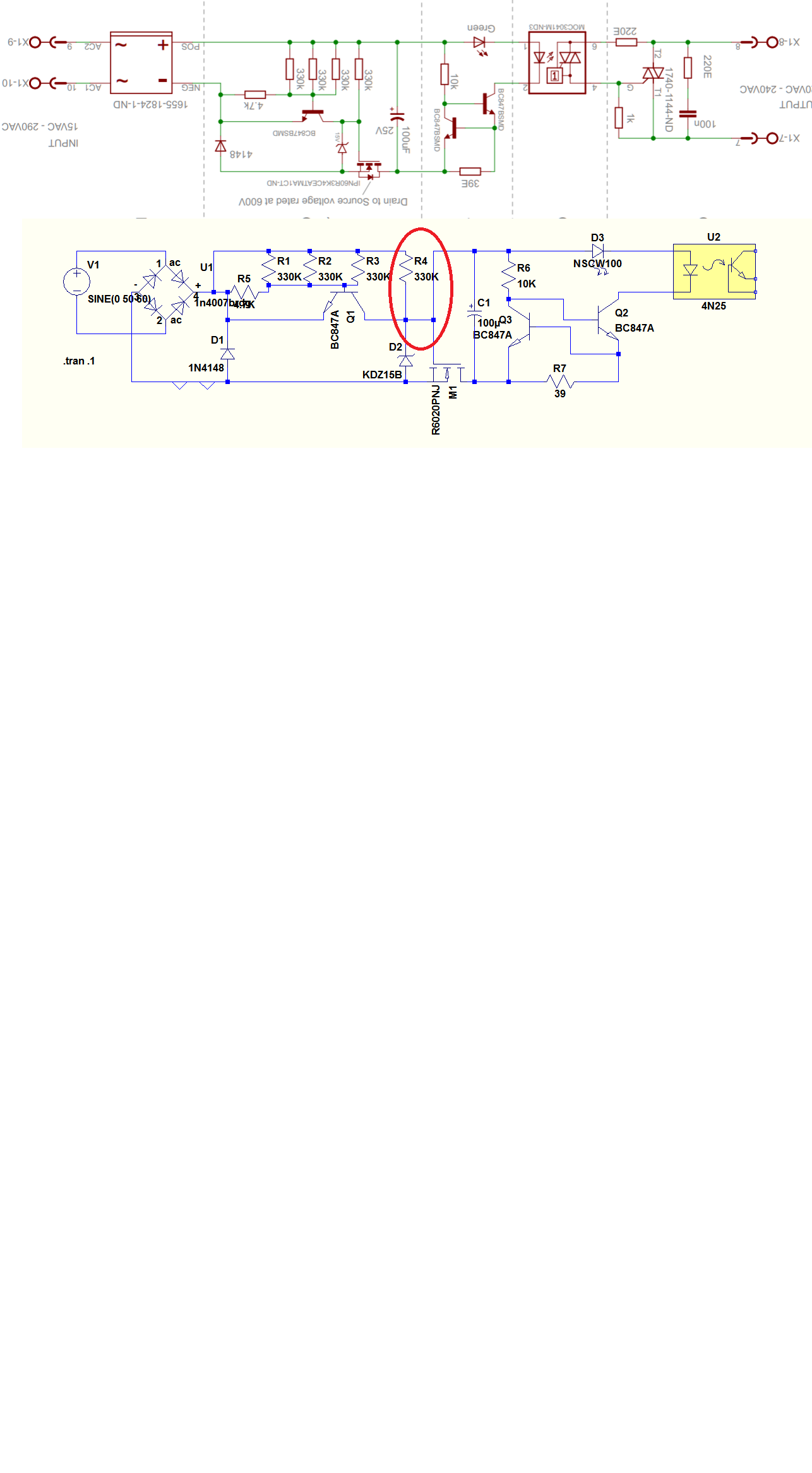

I think you drew your schematic wrong, I copied it to spice and it didn't work until I changed a wire, then it simmed correctly. You had the rectified voltage going straight to the optical isolator without handling it. YES - NO?
  • Draft6.asc
