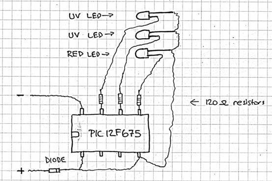

Hey, could i use this circuit shown in this simple picture?
I think it will have to be programmed beforehand, but i can get the software here -> **broken link removed**
and i can always buy a PIC programmer off of ebay or somewhere?
:confused::p

I'd think that unless you already had the programmer and a little experience with PICs, the schematic that Hero posted a link to would be a good place to start for the fading LEDs. You could then run the motor and the fading LEDs from the same 12V source. I know that the schematic Hero linked to specifies 9V in but it should run just fine off 12V (though you might want to tweak a couple of the resistor values to get the fade rate to what you want, and to control the current to the LEDs).
You didn't say whether the motor just needs to continuously run in one direction or whether you need to reverse it.

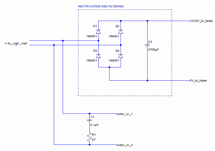

Hi again,
OK, this is a simple unregulated rectification and filtering circuit for the sculpture:
rect_filter_1-png.21019
I'd suggest trying an adaptor with 12VAC output on this, but maybe try a 9VAC or so if you have it, since after rectification and filtering, the 12VAC in will result in more than 12VAC out. If the motor causes the adaptor to sag sufficiently, though, a 12VAC adaptor may be necessary.
R1 and C1 are there to protect the rest of the circuit from inductive kickback from the motor when the thing is turned off. Your motor isn't very big so that might not be much of an issue, but I'd include them just to be safe. Use a 1/2W or 1W resistor for R1 and a non-polarized (important!) capacitor for C1. (Note that I'm no expert on RC snubber design but I believe the values given should be OK here.)
The four 1N4001 diodes rectify the 12VAC to DC, which comes out as a DC half-sine wave at 100Hz. C3 smooths that to something resembling a steady DC voltage, after which you can use the output to power the fading circuit. If you find that the fading circuit behaves oddly you can add another 4700uF cap alongside C3 to smooth the output even more, but at 100Hz you shouldn't notice anything anyway.
Hope this makes some sense and helps a bit,
Torben
P.S. I also hope any glaring goofs are corrected by those who know better, as always. I haven't built this, just drawn it out. :)

Thats great! As long as i have a Schem. with the right values and components, ill be fine working from that to make a circuit :D
Im not so sure about that non polarised capasitor though...
The closest i could find to it was this...
:confused:
Torben suggested a .1 uf capacitor, not a 1 uf.

Yeah, I did, but only because that's a value I saw used in a similar application. I'm still chewing through a PDF on snubber design--but right now I'm working on fixing Grandma's pressure washer, so the snubber might have to wait until tonight. ;)

Just figured out the capacitor values... 4700nF isnt the same as a 4700µF....Went and bought the wrong ones, lol.
I understand it now but the larger value capacitors all seem to be electrolytic and have a required voltage. What voltage capacitors do i need or do i just need to get ones under 12v?

For a circuit designed for 12V operation, your lowest available (that I know of) option is 16V, and that's pushing it. I'd go for at least a 25V-rated part to make sure you've got the headroom to not exceed the cap's rating even in a worst-case scenario. The 4700uF cap will be a polarized electrolytic, so make darn sure you hook its negative lead to ground and not the other way around--otherwise it could pop and get hot stinky goop all over the place.
The 0.1uF cap on the RC snubber across the motor leads, on the other hand, doesn't care which way it is hooked up, since it *must* be non-polarized: it's operating on AC, so its positive and negative side will be swapped at 50Hz.
