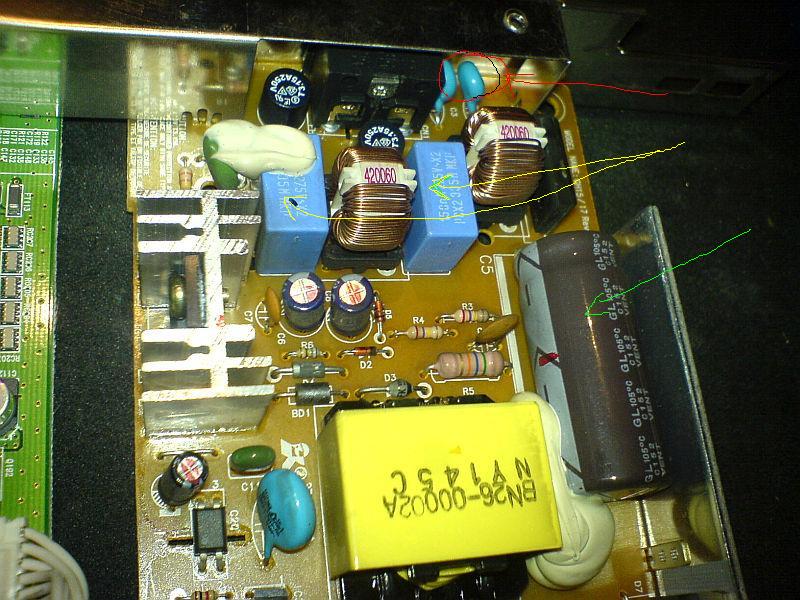

I've got a set of speakers called Creative Gigaworks S750 and they've gone out with a bang. When they work they are a truly fantactic piece of kit and I'd love to be able to fix em. I don't like throwing expensive stuff away when it might still be fixable. It would be such a waste.
The in-built fuse went and I changed that for another only to have that go too. I've taken the sub apart because that's where the amp is and where the flases were coming from :eek: and I've found a smokey part on the PCB. Nothing else appears to be smokey or fried. I think it's a ceramic disc capacitor but I'm not sure. See what you think. This is what it says on it:
sec 471k
sb 250v~x1y1
400v~c
And it's blue with two terminals.
Here's a pic of one from another forum. It's the one encircled in red at top right:

I see your problem!!!
See the big brown capacitor on the right of the picture?
Its top end is bulging, indicating that it is bad.
That might not be just so however-
-A power surge could have blown something else, and made the cap bulge too
Pull some of the parts-driver MOSFET- capacitor- bridge rectifier-etc.. and use a Multi-Meter to see if any of them are shorted.
-Ben
The blue capacitor that you think is blown, doestn't look blown. It's a class X2 rated capcitor. Those are rated for across the mains, and when blown are real obvious. Your problem will most certainly be start up capacitors and resistors allowing the output to climb until the fet chopper transistor failed. This will also take out the smps fet driver chip and probably the low ohms resistor on the fet. Replace all small capacitors with low esr 105 degree types in the primary of the supply and the fet and the smps driver chip. Lift one end of all the resistors in the primary and measure them, I suspect at least one of them will read high or open. On an odd occasion the opto coupler and or TL431 type regulator may also be damaged.

Sorry for creating unnecessary confusion. That isn't a photo of my PCB, it's unrelated to my problem and is form another forum. It came up in google images when I seached for sec 471ksb 250v~x1y1 400v~c. I was merely using that photo as an example of what the capacitor looks like. I apologise.
I've thoroughly checked my PCB for damage and the blue capacitor is the only visible faulty component, however if you'd like a hi-res photo it can be arranged. :)
Those caps can short circuit on their own - probably took out the fuse (the black round thing above the caps saying 3.15A) - i'd try replacing those caps and fuse.
Ok, I sort of agree with Exo in this case, they do have a tendancy to go short for no apparent reason, usually over volts, but will usually blow themselves apart or crack and split open. Replace them and the fuse, but before powering it up, measure the chopper fet and bridge rectifier for shorts.
I would still replace the low value capacitors in the primary at this point, no sense in risking the smps going into orbit if they are faulty.
A hi-res photo of the actual board will help folks get an idea of the kind of smps in use.
