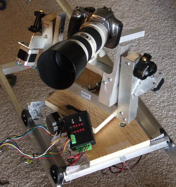

Here's a picture of the contraption (mounted on an experimental motorized rail, but normally sits atop a tripod). the black box is just the motor driver. One light for each stepper pole. controller is still on a breadboard.

It's rather more than is needed for a gigapan, but fairly modest in terms of what is needed for good motion timelapse filming.
Nominally it has 0.03 degree precision, which means I shall definitely buy a 50,000mm (50 metre) lens and make a 100 Terapixel image of my apartment.
So far it's cost about 100 dollars per axis, several weekends, and many hours of gurning.

Of course, forget the worm gears (damn hard to find anyway). Use two (instead of my 3) steppers (but I strongly recommend NEMA 23 size for directly moving a dSLR). I used pricey precision bushing/shafts from servocity, but not necessary for the gigapan. The wood i found... Yes, a basic direct-drive rebuild of this would be ~100. I wish you lots of luck and don't forget the lazy susan.
