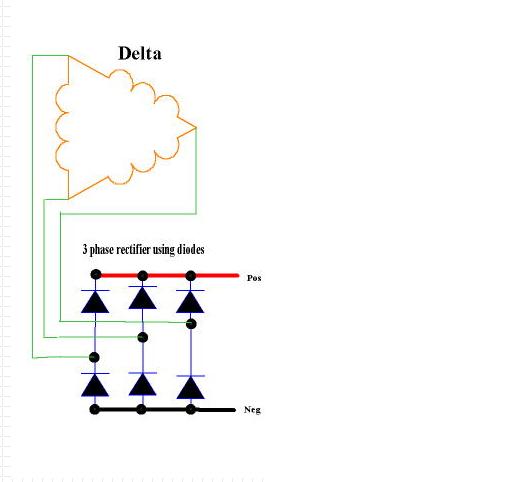

Newbie here looking for help with a circuit for a generator to charge the battery on a large remote control helicopter.
Basically I'm looking to mechanically drive a brushless motor (3 phase) from the output shaft of the engine, rectify this and use a voltage regulator to supply 5.6v to my battery pack.This would allow me to fly almost continually (dependant on the petrol tank level) without having to worry about voltage dropping in my electronics.
I am an electrician by trade have soldering and pcb manufacturing knowledge from my apprenticeship, just cant remember anything about cct design!! it was 20 years ago :) so really I need a boffin who could tell me what components to use and a connection diagram.Any advice greatly appreciated.

generator info
ok guys here goes :
output from generator is 6.5v ac
KV = 850 rpm/volt
Rm=0,169 ohms
IO=0.6A
Unregulated o/put =12v 10A
After regulator 5.4-5.6v
Batteries used will be Nicad 1400mah
rotational speed of generator approx 11000 rpm not sure if that equates directly to freq. for a brushless motor but should be around183.3 hertz if my maths is right!
motor being used is Himax2812-850

Ive seen a cct where there is a 2200 microfarad capacitor with the three lots of diodes in parallel with it but I'm not sure why-smoothing?.
The resultant dc o/p then needs regulating to 5.4v to charge the battery and I dont know how to regulate the voltage or the current never mind work out what components I need!
Can I use any diodes or do they have to be a specific type?Sorry for the questions but as i said its many years since I studied electronics and its a case of use it or lose it.

For one thing ,To actually charge your pack you will need more than 5.4V to push the current into the batteries..
From what i've seen of the generator you want to use , it has more than enough power ..
what is the power drain of the electronics ( of the copter) you are using??
Typed in volt reg into browser and found some info,could I use an LM338 which can handle 5A or an equivalent type of thing?
if so how on earth do I connect it and what else would I need in the cct?

So the pos connection from the rectifier goes to the Lm338 and do I just tie down the neg from the rectifier to earth/ground?
one last question-if i can get this to work is there an automatic way to stop outputting to the battery when its fully charged or will constantly outputting to the battery be ok?
How much power does your circuitry draw.??
yes the ground from the rectifier goes to the ground on the regulator and to the negetive of the battery pack..

all up the servo's, lights, retractable undercarriage,electric start and siren should pull no more than 5A
