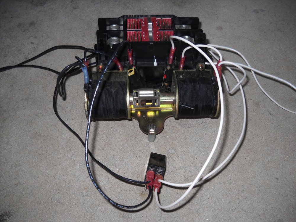

I recently installed one of these.
http://www.deepseaplc.com/genset/auto-mains-utility-failure-control-modules/dse4520
It works great. It senses power failure, starts the generator and sends a signal to operate the transfer switch. My transfer switch is 200 Amp. You will need one much bigger.
