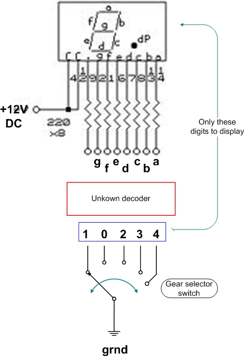

I have a 110cc Chinese motor made by Lifan. It has four gears and a selector switch for gear indication that unlike some gear selectors I have read on this forum that have a variable output, this closes to ground for each gear. I was wanting to build a gear indicator using a small seven segment display. The SSD only needs to display five digits. 0, 1, 2, 3, 4. (and maybe a 'test' to light all segments)
The end result is when the motor is in Neutral, '0' is displayed, first gear '1', and so on.
I have been searching and reading about SSD, 4511 & 7446 decoders, Truth Tables, BCD, Binary and I am getting confused. I thought this would be a rather easy project but I am finding it may not be. The alternative is to skip the SSD and use seperate LEDS for each gear. That's cheesier than I want to do so I need a diagram showing how to make this happen and what components, (decoder/driver?) to use.
There seems to be many SSDs out there. I understand common Cathode/Anode. Is there one that is flush mounting? Looking in the size range of about 1/2-3/4 tall digits. It needs to mount on or near handle bars/gauge cluster.
Here is a quick diagram of what I think I need.
Any links or input is appreciated!

The simplest solution is to use a bunch of diodes.
You need a diode for each segment, for each gear. So for neutral (0), you need 6 diodes. The cathodes are all connected to the neutral connection on the switch and the anodes are connected to the resistors for segments a - f. 1st gear needs 2 diodes, with both cathodes connected to the 1st gear connection on the switch and the anodes connected to the resistors for segments b and c.
And so on.
I make it 23 diodes in all. You could use 1N4001 diodes that cost a few cents each.
You could do it with fewer components, if you used the decoders or even a microcontroller, but finding out how to do that would take a lot longer.

You could use a CD4532B (or similar) 8 input priority encoder to convert the gear positions to a 3-bit binary code, and then a CD4511 (or similar) to convert the binary (BCD) to a 7-segment display output.
Since the gear indicator switches go to ground you will need to add an inverter (CD4009) to give the proper logic high signal to the encoder inputs when the switch is grounded. Use a 10k pull-up resistor to V+ on each switch output to generate the switch voltage levels to the inverter inputs.
Edit: Make sure all unused inputs on the CMOS circuits are tied to ground or V+. Do not leave any inputs floating.

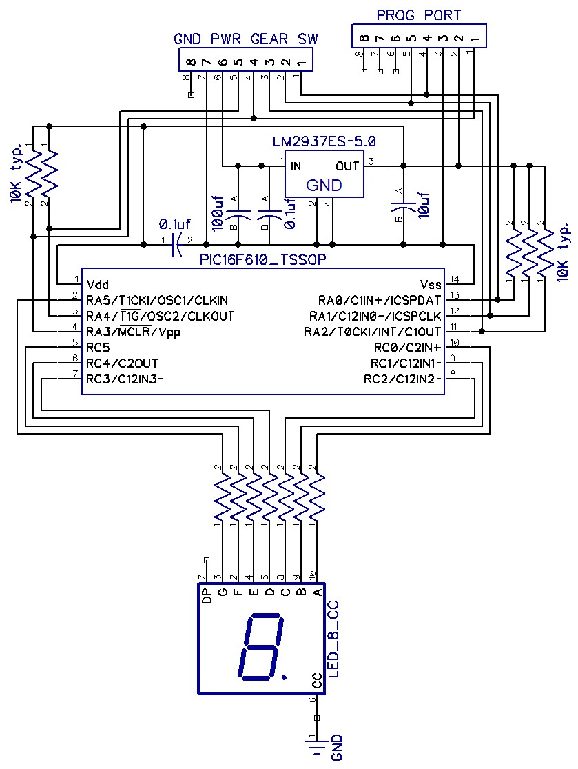

Here ya go....a microcontroller circuit:), certainly the long way around to your problem. With surface mount parts, the pcb fits behind a 0.8" character SSD width wise, but would have to be a little longer because of the caps.

Thanks for the drawing NF!! I do appreciate your help. A few questions to be sure I am on your page:
Is this correct?
Top of the diagram
8 & 7 = Gnd
6 = 12VDC+
5-1 = input wires from my gear selector on the engine
I am unclear what the 'program port' connects to or what its for. Being 1-5, I am guessing it has something to do with the gear selector switch on the engine??
The five 10K typ. resistors, is that the value, (10k ohms) or do I need to confirm an 'actual design value'?
I have found formulas to determine the resistor sizes for the SSD. Do these resistor values also control the LED brightness? Or do I look for LED brightness spec when purchasing the SSD?
Does the SSD ground, (pin6) need to terminate at the PCB or will the bike Chassis ground suffice?
The schematic is based on the assumption of a negative ground. I've seen a positive ground three wheeler, forget what make. The voltage regulator is a heavy duty automotive grade. Hopefully there is a battery? All bets are off if this is solely a magneto driven circuit, haven't messed with them. Not sure what extra requirements are necessary.
Yes the numbering is correct, 1st gear goes to pin 1, 2nd gear to pin 2 etc.
The program port is for in circuit programming (ICSP) of a PIC microcontroller. This is a common way to do it, and relieves shuttling a chip back and forth from the circuit during prototyping.
Like I said, this not a shortcut. You need to program, or find someone to program the code. Then, the code needs to be burned to the chip with a programmer like a PICkit 2 or 3. If that is not in the books, then maybe someone will come up with an analog solution for you.
10k pullup resistors for the gear selector inputs should be fine.
The SSD resistors were deliberately left out, and depends on type, and color of led display purchased. The data sheet will give drive current, forward voltage, and brightness of the leds. It may pay to get a couple different ones to compare, like Avago, Lumex, etc. Avago advertised a daylight viewable AlGaAs SSD.
Don't be confused about the SSD pin numbers, as the schematic uses a "generic SSD", and will disagree from the datasheet. If you set the pcb as remote from the SSD, I wouldn't trust the handle bars as ground. Chassis ground should be O.K.?
