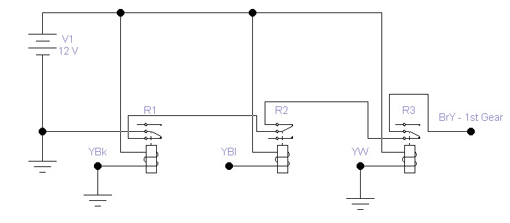

If you want to do it with relays then buy three 6PDT relays with coil voltage rating equal to the battery voltage.
Connect a relay coil between the battery and each of the gear selector outputs respectively. Black wire goes to battery common. (Note: Remember to put a diode across each coil to suppress contact arcing, diode cathode to positive side of coil).
Connect all wiper contacts of the YBk relay to ground. Connect one wiper contact of the YW relay to each of the indicator wires respectively.
Now you will need to draw a connection diagram for each relay position so that the proper indicator light is lit for each gear position.
An example for 1st gear is shown below (only one of the six sets of contacts is shown for each relay). Thus for 1st gear YBk and YW are grounded, energizing relays R1 and R3, but not R2. Thus, with the wiring shown, there is a path from BrY, 1st gear indicator, to ground, lighting the 1st gear display.
Do this for the other 5 sets of relay contacts to get the proper indication for the other five gear positions (and relay positions).
