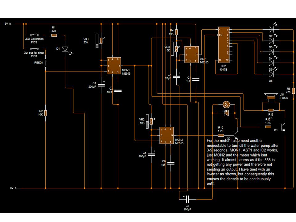

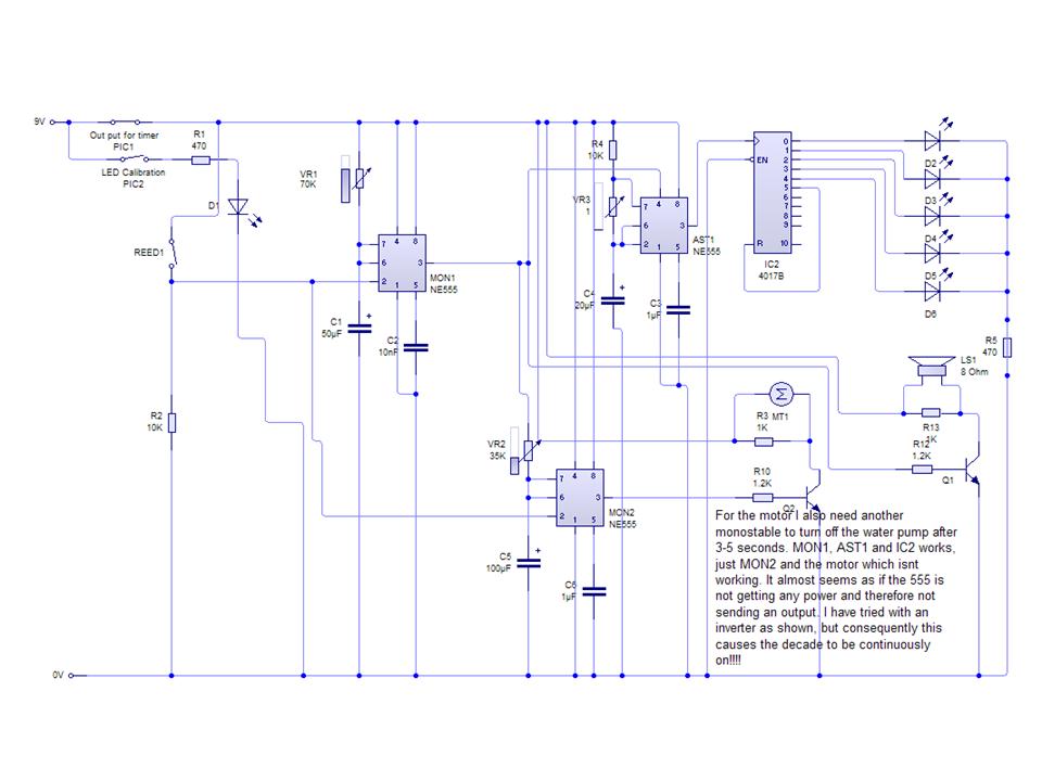

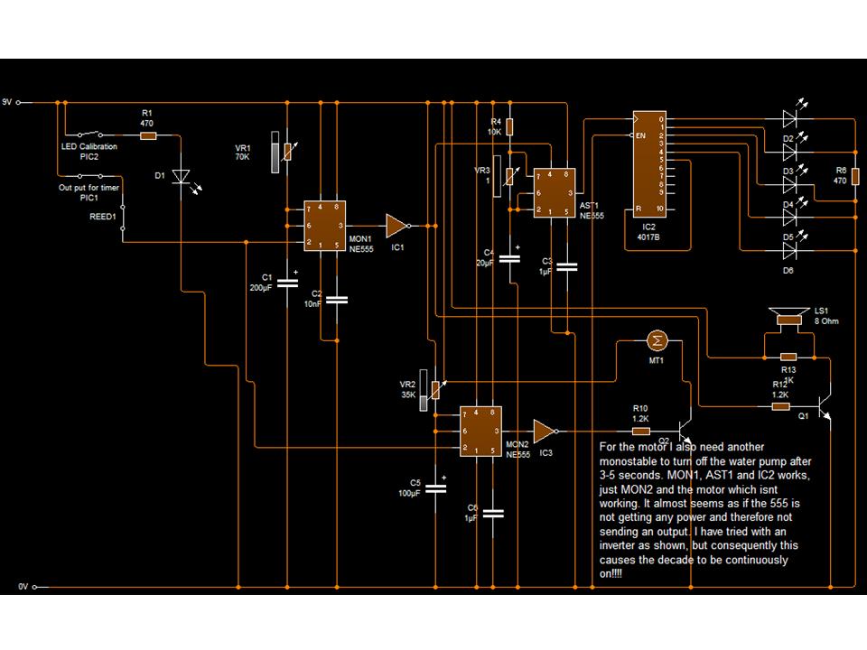

Hello there, I am currently trying to work on my GCSE electronics circuit schematic using the program live wire. I am designing a safe alarm which will when the door is open at certain periods (ie overnight), then in conjunction with a PIC sending out a high pulse (maybe low) a reed switch will trigger a circuit. When the circuit is triggered (hopefully) it will use a monostable to delay before the output of the circuit (siren, lights from decade counter, and a pump to spray smart water). Then the siren, and lights will stay on indefinately, but the motor should go off after 3-5 seconds in order to not burn the motor/pump out. But when i engange both switch (reed and PIC) then the motor will only stay on as long as it takes for the capasitor to charge. I really am stuck, and I am running out of time. If anyone would could help me then that would great :D
  • Seems to work but only works if i press reed quickly, open it then close it. (before cap is char.jpg
no no no, the PIC is being uses as clock, and timer which will arm the alarm at night time. So that if the safe door is opened during the day then it will have no effect, but at night when the PIC is active then it will. Anyway any ideas..?
no because ive been told the way the mark scheme is done that I need to include conventional components otherwise it just looks like a programming exercise. Still anyway of doing it?

thanks for your controversial discussion guys, but could you please help me with my circuit! It seem capacitor 1 is the problem. Like if i press down the reed switch with a rapid on/off/on then it works with the inverters and switches in parallel. But if the pic switch is down for a period of time and the reed switch is broken, then C1 charges, and from what I can understand when capacitor is fully charge it dis-engages the motor. Our old teacher has left and we have a new teacher who although she is trying her hardest doesn't have the expertise our old one had. So please help!
You appear to be running the motor off of the same power rail as everything else. The motor will put a lot of noise into the system. You need to figure out a way to separate the two. Speaker could also cause a problem. No back EMF diode on the motor.
I'm not surprised you are having problems - you are running on ugly power.
so what should I do stick a diode in where the motor is running to negative? I really know I shouldnt ask for help but I AM running out of time, so some strong pointers in the right direction would be useful
At least you're asking for help, not just expecting us to do it for you.
There needs to be a diode in reverse parallel with the motor to protect the transistor from the high voltage spike produced when the motor is turned off.
sorry i havent been taught about reverse parallel could you just put a little ring on the diagram please. And this wont help with the problem of how to turn the motor off once the circuit is trigger. Is there anyway I can stop C1 charging when pic switch engaged but reed switch is not? Then it begins charging when reed switch engaged. Cause if I can do that then I have a working circuit I think.

Looking at the cct, you have a VR1/C1 timing period which can be set <= the timing period of VR2/C2.
As VR2/C2 is only being charged during VR1/C1 which sets Mono1 output high, how can Mono2 reach full charge.??
Why dont you trigger Mono2 with Mono1 rather than trying to control the charge voltage/time.

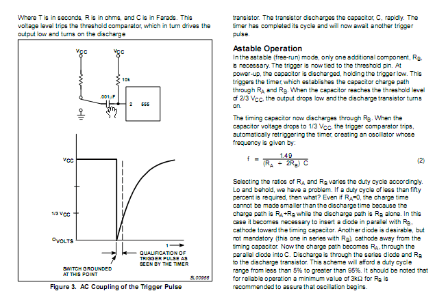

You need to 'ac' couple the switch action, look at this image.
Do you follow.?

ok I didnt really understand that, so what would I need to actually do circuit wise put two resistors in parallel to the circuit. And would I put in on MON1 or mon2? Thanks this has been the most useful post so far!
What the Res/Cap on the trigger input does is to 'differentiate' the edges of the switch pulses.
All that means, you push and hold the switch and the cap sends a short low going pulse to the 555 trig input. Release the switch and a high going pulse is created which does nothing.
This is the same as you were doing at first, pushing the switch quick on/off.
Look at the circuit I posted, use a about a 1K0 reslstor at the switch, then the cap and the resistor shown of the circuit.
Make the same circuit between the mono1 output and mono2 trig.
EDIT: Look at this image.
