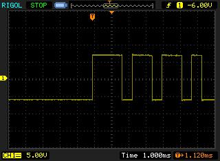

I have an old Rand McNally GPS for the Palm PDA. I don't remember if I ever had it working with the Palm, but I decided to make a small tracker with it using this hack: https://www.qsl.net/n2ixd/tracker/hackgps/index.htm
I get regular "data" output, but it's just gibberish. I have tried every possible serial setting on my terminal program, but still nothing discernable comes out.
Any ideas what could be wrong, or what else I could try?

Sometimes you need to put an oscilloscope on the GPS output to see what is being sent. There are lots of different things that you have to get right:-

I was finally able to scope this. The voltage levels are -7 to +7V and it doesn't look like there is a start bit. Also the GPS board makes a high pitch, low volume, screech sound when I put my ear down on it.
Your scope trace shows 12 or so bits;
111011011010
of which appears to be 2 bytes, there seems to be an obvious Start and End bit here;
S11011011E
followed by what looks to be the next start bit and partial next byte;
S0
to me it looks like standard 8n1 serial with one start bit, one end bit and no parity bits.
If your scope is 1mS per division, 10 bits is 5.8mS so each baud looks about 580uS so baudrate is about 1/580uS = 1720 baud which seems a little unusual and might be why you are getting garbled output?

Thanks for the help on this, Roman. I recorded a longer trace and manually decoded it to read: "$GPGGA," Awesome! You're right; it looks like something is wrong with the baud generator. I'll probably just build an interface.

Excellent work. Do you have a better scope trace?
I would like to see what baud rate it is putting out, out of curiosity. Normally GPS NEMA defaults to 9600 baud but some older units use 4800 (or can be switched to 4800).
I measured it at around 588us per bit, which is about 1700 baud. It did vary a little, but it all seemed to stay within 7% of that. You nailed it!
I'm going to write a routine to go with 1700 and edge-align to correct itself. It's strange that it outputs this weird baud rate, though.
Cool, thanks for the info. Since that GPS was made specifically for the Palm PDA it may have been designed with a specific baudrate to suit the xtal speed of the Palm. The baudrate is most likely original and meant to be 1700.
