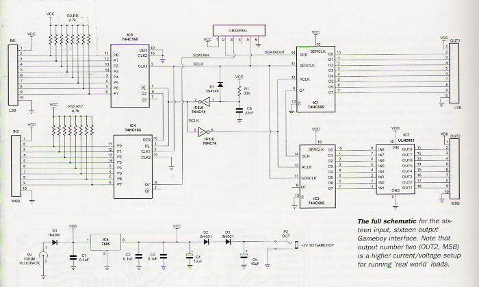

Hi Guys,
I found this interface for a Game Boy Serial (link) port. Could I use this for a PC serial interface? If not, how would I modify the design?

It was in a magizine I found (Electronics Australia June and August 2000 editions). There was an article about programming a gameboy so it could control motors etc. through its link port. They provided a schematic for the interface to the port. However, I don't have a gameboy and was wondering if the interface could be used on a PC port.
Sorry, about not attaching the schematic earlier, I was experiencing problems uploading it.
