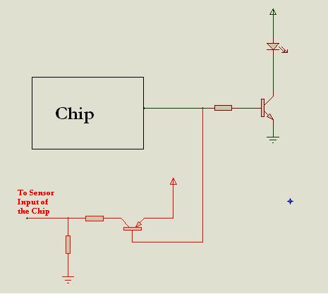

I see what you are saying but the LEDs are turned on and off sequentially by the chip. There are 6 "banks" of 10 LEDs each that are connected to 6 different pins on the chip (single simplified diagram):
Granted I could bypass the chip completely and just have the LEDs all turn on and off at once but not only is that not as "cool" there is also audio output from the chip as well that needs to stay on. If I can "emulate" the sensor activation I retain all of the these effects.
How about If we add a PNP transistor(see the schematic).
When ever the Controller tries to turn the LEDs off, it receives a logic High signal from the transistor, When the Leds are on, It gives a Logic low level

At this point I have solved my problem with a simple 555 timer circuit (pretty much what I was going to use from the beginning, but I thought I would check on my thinking :)).
I just finished testing it and it works perfectly. The 555 timer emulates a sensor "firing" every 90 seconds, thereby keeping the auto shutdown from occurring.
