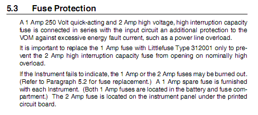

Why would anyone put a 500v 2A fuse in series with a 250v 1A fuse in series with the common lead of a Simpson 260?

This is what the 260 manual states:

Thanks, Mr. G.
I've e-mailed Bussman and Littlefuse for trip curves on these buggers. I see now that I also should have asked for interrupting capacity.
I also cut & pasted your link for further reference.
Today I have learned something.
Thanks, Mr. G.

The early Fluke multimeters also had two fuses.
The idea is that a cheap fuse will blow if the current is a bit larger than it should be, where the current is 10 amps or so, or where the voltage is small. This is quite common so it is convenient to have a cheap fuse.
If the meter is used incorrectly, and left on amps and connected to a high voltage supply that can supply thousands of amps, the is a big risk that the cheap fuse will not stop the current. The short circuit current can exceed the Breaking capacity - Wikipedia, the free encyclopedia of the fuse. The current continues to flow across an arc where the fuse used to be.
This is when the expensive fuse blows and saves the user's life / sight / eyebrows.
The plot thickens. . .
The Interrupt Rating for the 312001 (1A) is 10kA @ 125Vac, 35A @250Vac., and for the BLS002 (2A) it's 10kA @ 600Vac
Apparently Simpson was concerned interrupting current from voltages over 250v. Higher V is more prone to arcs.
