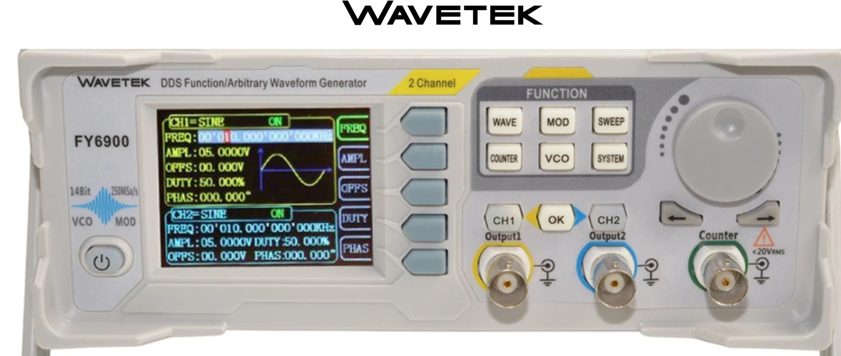

Hope all are well today
Any words, good or bad, about this generator, would be greatly appreciated before I whip out the card.
Perhaps you would care to tout a different generator for quality or more or better features.
I am a hobbyist with no specific project in mind.
Wavetek Function Generator (60 MHZ) FY 6900​
Speaking from a position of no direct experience of that particular generator...
Wavetek have been in the function generator business for a long time, and have usually made reasonable equipment.
However, looking on the interwebs I found an identical looking generator, the FeelTech FY6900, which has been reported by a couple of people as having problems.
Others seem to have no problem with it.
I am guessing that it is a design which has been badge engineered by various companies.
As a general purpose signal source it will probably be fine
However, as a hobbyist, if your scope of interest includes radio, you will probably find that the output level and direct signal leakage from the case make it unsuitable for meaningful testing of receivers.

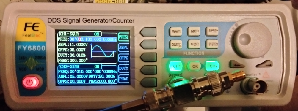

I have several. All I know of, do not make a square wave at maximum frequency. At 60mhz it looks like a sine wave. Even on the really costly generators.
Here is a picture of what I have for the about $160usd. It stays on 24/7 for a year without trouble. I also have a $8000 one that I don't use.
If you really need a square wave it has "TTL" outputs on the back side.
It appears to me that one company makes the PCB with parts and several different companies put their names on it.
I got the generator because I needed a pulse every 10 minutes that slowly shifted to every 1 minute over two days. These things are really programmable.

The wavetek probably a china knock off. If you can see a pic of the board inside and
compare with China clone I would lay odds they are same.

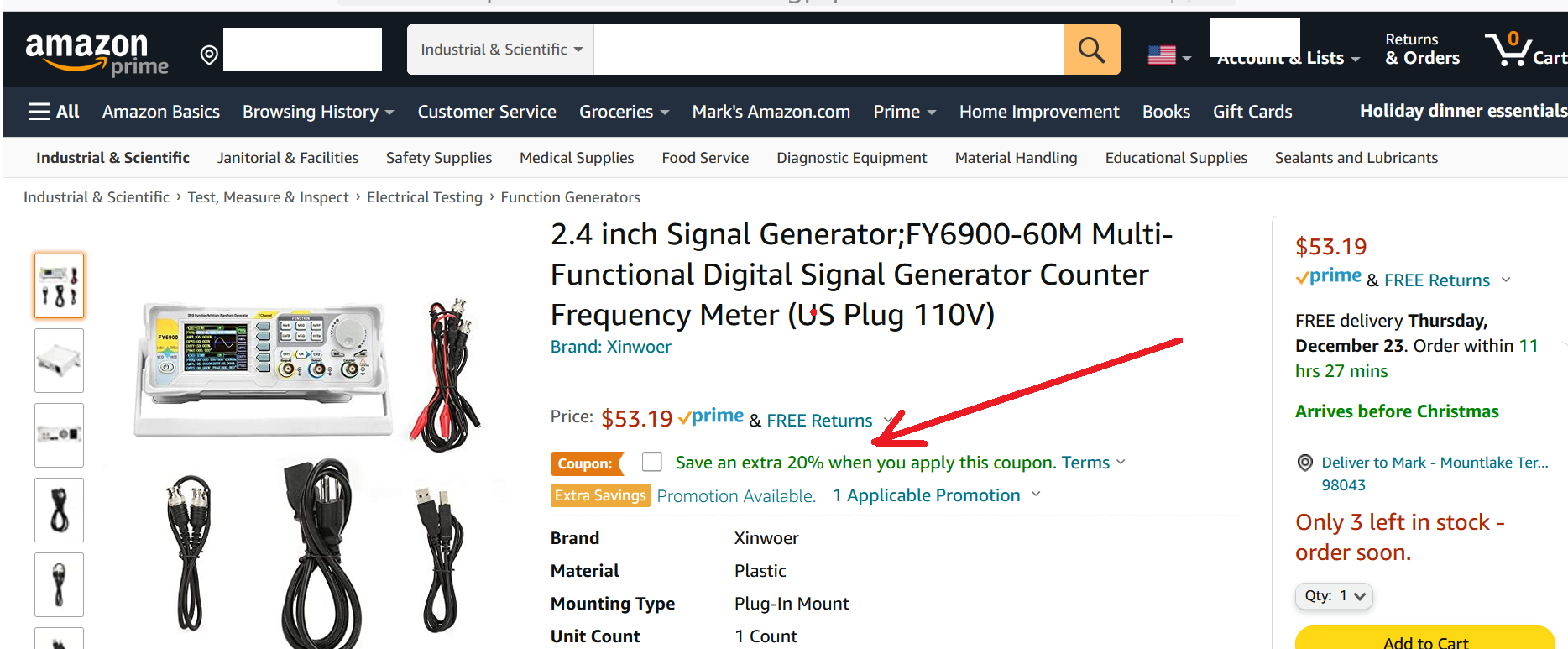

Ok, kids only fair to tell you all I bought one. Before I tell which one and how much I must thank all that chimed in.
JimB thanks for the extra poop on output an leakage.
Dana, JimB and Ronsimpson thanks for pointing out that there is one product and many names.
So.............I think I found the cheapest, Dana are you proud?
I paid $42.55 b4 tax and after a 10% coupon
