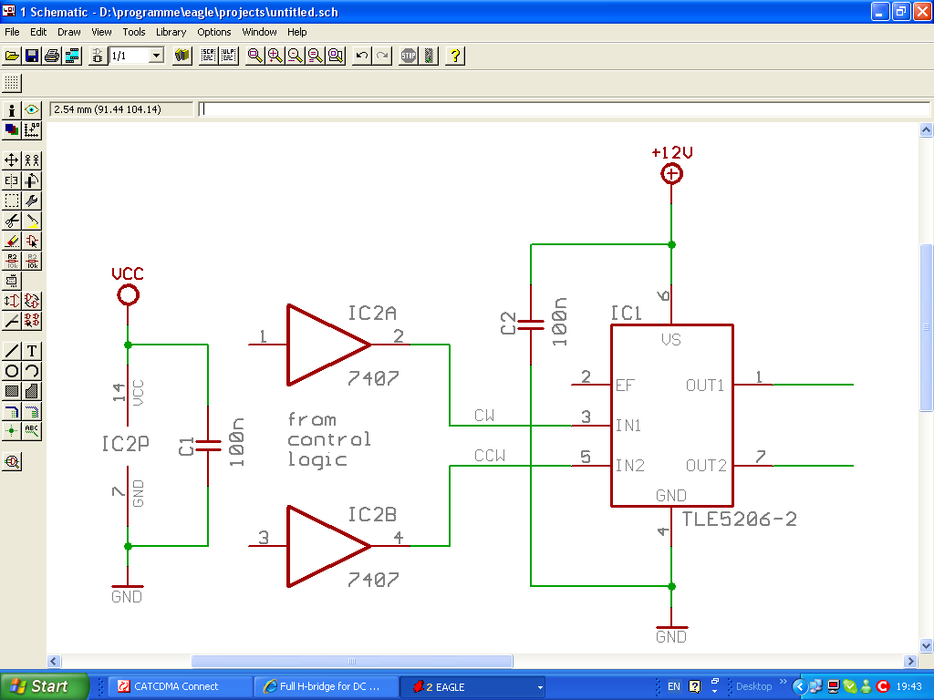

Hi dknguyen,
I didn't quite understand what should be floating in a circuit with common ground. The reference voltages will be ground and +VS (+12V).
I made a small schematic omitting most of the decoupling measures. Please be so kind as to explain what could be floating in that circuit.

THe high-side transistor will not turn on and stay on properly. It cannot provide a voltage difference between the gate and source that is high enough. It is the voltage across the gate-source that matters, not the voltage between gate-ground (unless the source is connected to ground like it is in the low-side MOSFET).
I'm not worried about that. It applies to every H-bridge though. The chip design should have taken care of that already. Otherwise the chip can be considered to be junk.
Oh that chip is an H-bridge. NEvermind. I thought it was just a gate driver.
:confused::confused:
Already forgot it? It was you suggesting the chip.
