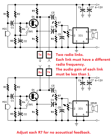

Good day everyone! :)
I need some help here.
Do you have any ideas/suggestions to make this circuit diagram to become a full duplex wireless intercom.
Full-duplex Intercom - RED - Page78
With a range of minimum 4meters
If I will substitute a transceiver/transmitter and receiver, what preferably diagram should I use? and how?
Appreciate your reply.
Thank you :)
You can't convert that wired intercom to wireless.
For wireless duplex you need a transmitter and receiver that operate on different frequencies.

Don't see how it's possible.
The wires connecting the two intercoms stations have audio signals going in two directions.
I think my wireless schematic might work:
