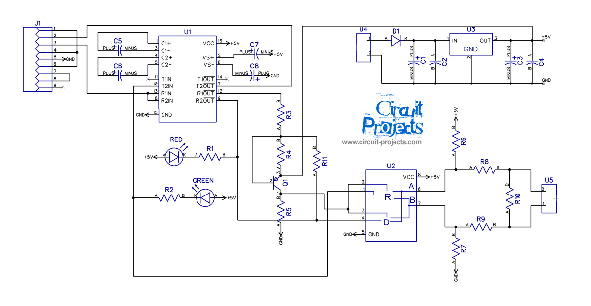

Hi JimB
I have attached the schematic here
I am connecting the PC serial port to MAX232 and connecting RS485 A & B to a device which can read and write data.
I send a command from the PC (on hyperterm) to access a single byte of data from that device,which unfortunately isn't serviced. But when i set the device to send data continuously , i can see the data on my hyperterminal window.
That circuit seems to want to do things the hard way , most bizarre!
Have a look at my attachment, it is a thing which I put together a few years ago to use as a demonstration and worked OK.
I used the RTS signal to switch the MAX485 tx/rx sections rather than the convoluted connection driven from the tx data as per the circuit which you have used.
I suggest that you try my circuit, it should be easy to modify from the one you have already.
When using hyperterminal on the PC, you will have to set the PC serial port for hardware handshaking.
