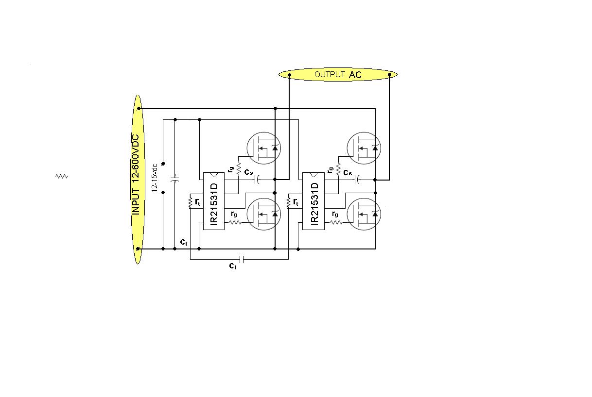

This is a full bridge MOSFET or IGBT with the programable oscillator that made with the help of couple IR21531D. I would wonder if someone make a test on this circuit. I did and it has worked excellently but there is no suitable equipment at home to determine about advantage and disadvantage.
What are you using it for?
An inverter?
It is. The circuit works out all the range of frequency from 0.1 Hz up to 100 kHz. In particular it has functioned tip-top during 50 Hz oscillating mode.

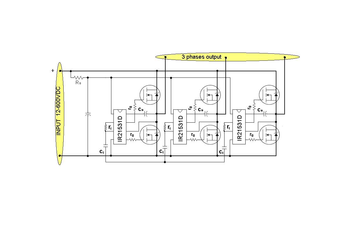

Also here is a method to get some three phases full oscillating bridge. That is created by the three IR 21531D.3ph..JPG

Here is not any modulation frequency like complicated three phases drivers. Here are three phases square pulse in interaction each other. Their phase shift 120 degree as needed to be. The most important condition it is the same kind of Ct capasitors in range 0.1-0.0001µφ and the same range resistors Rt. Frequency depend of them. Three phases have been created by circuit are suitable for three phases AC motor. I has already checked. If the modulation have to be, it would be added from DC supply unit.

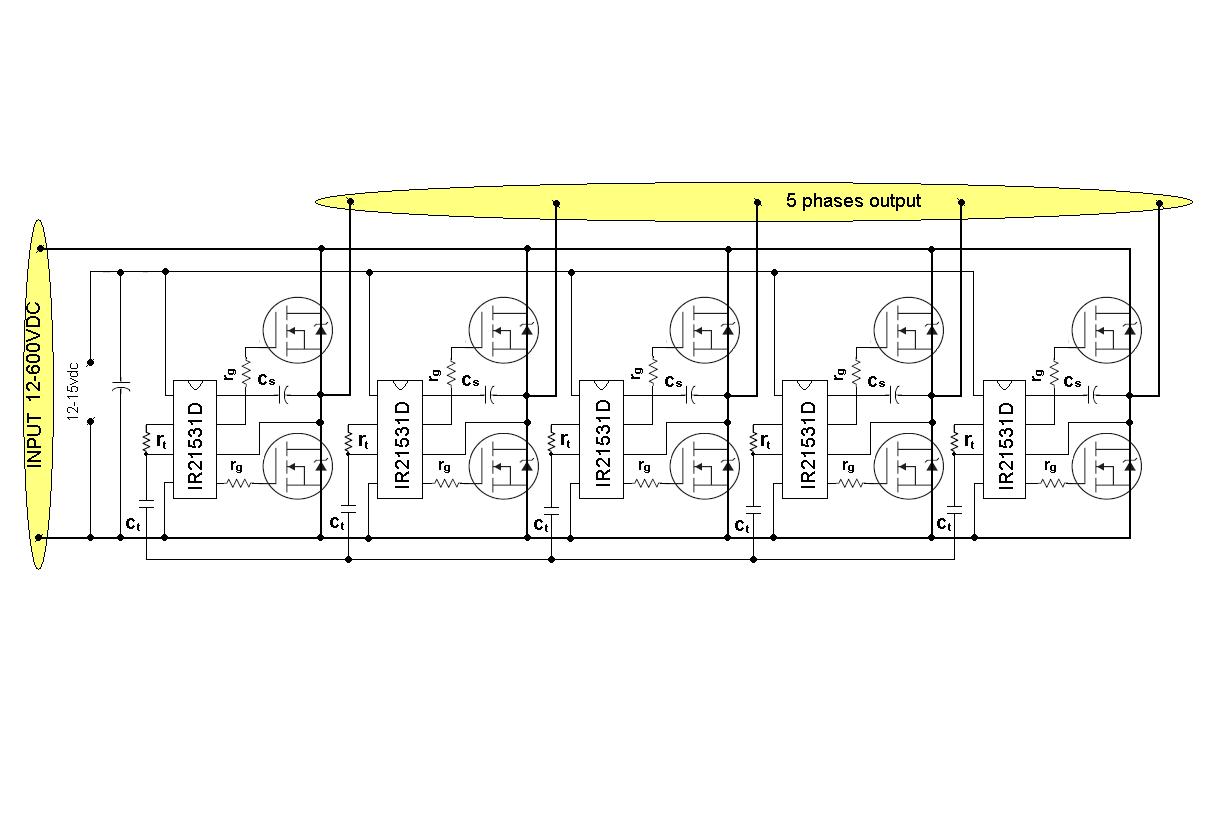

That method gives us create the full multiphases bridge MOSFET or IGBT. In particular here is a five phases bridge with self-oscillator.

Dvinchy- I want to ask a dumb question about this design. How are you synchronizing this to give the correct wave form out put?
According to the ir21531 data sheet they incorporate a basic 555 circuit in each IC. But there is now way to synchronize the wave forms. From what I know about 555 IC's you cant get two of them to out put the same frequency with out playing around with resistor and cap values, just because of manufacturing tolerances on components.
It also calls them a half bridge driver not a h-bridge.
Can you or some one else correct me if I'm wrong on this?

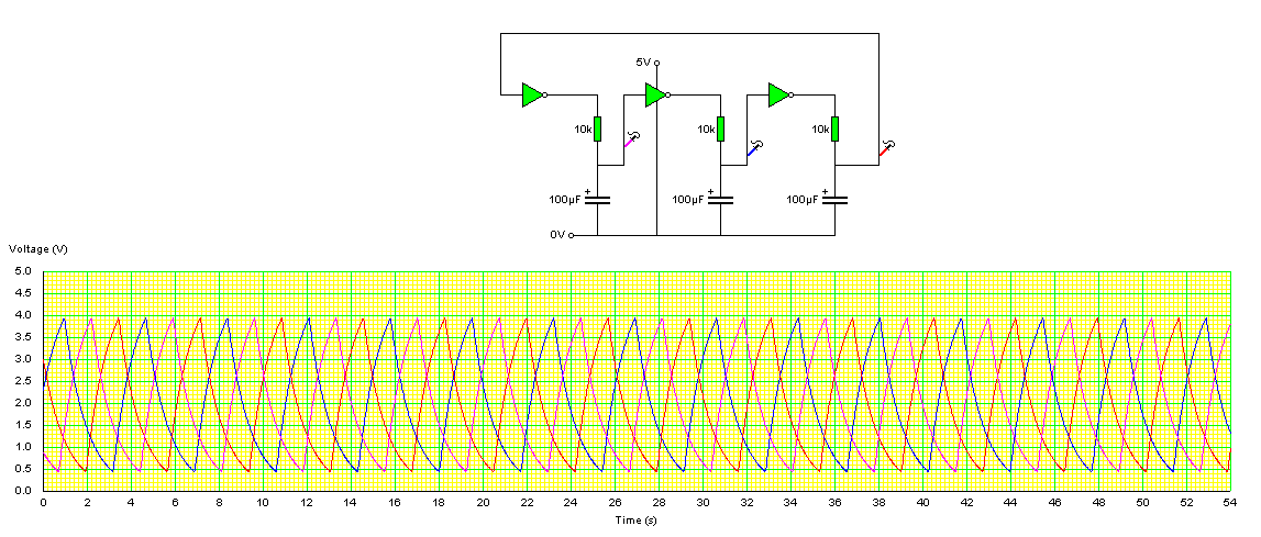

I haven't read the datasheet but going by the schematic it looks like a ring oscillator to me.
See attached, the plots are the voltages across the capacitors, notice how it's three phase?
The same is true for the squarewaves on the outputs of the gates but the capacitor waveforms are easier to see when places on top of each other.

The first two phases circuit is OK it was tested by me and worked tip-top. What about three or more phases i don't exactly know it was not tested with the load like a suitable motor but it has been tested with some resistive loads. As a result of this test all the voltage and amperage between each phases was exactly the same range. That is showing us the normal three phases mode. It is logical becouse three the same capacitors whose charging and discharging is depend each other will have to be taken sinusoidal shift.
I'd just said about the main reason why should a modified sine be. Take an imagine the situation when the power keys are functioning with out any sub-frequency-modulated they will have been destroyed in a short while. Even though there were a lightly load connected. There is a couple of decisions that is modified sin or increased current's range of transistors. The first one has probably more advantage than second one.
What do you mean by: power keys, sub-frequency-modulated?
Sorry but you seem talking nonsense.
Hero, Dvinchy- I am not nearly a well versed on this stuff as you guys. But as I understand it a inverter should/has to create a wave form that keeps the phases in the normal accepted AC form- whether 1 or 3 phase.
These driver chips have a internal 555 timer type circuit that controls the switching frequency. There is no way, that I can see, to tie one to the next so that a regular AC wave form is produced. The out puts from the FET's would just be random.
