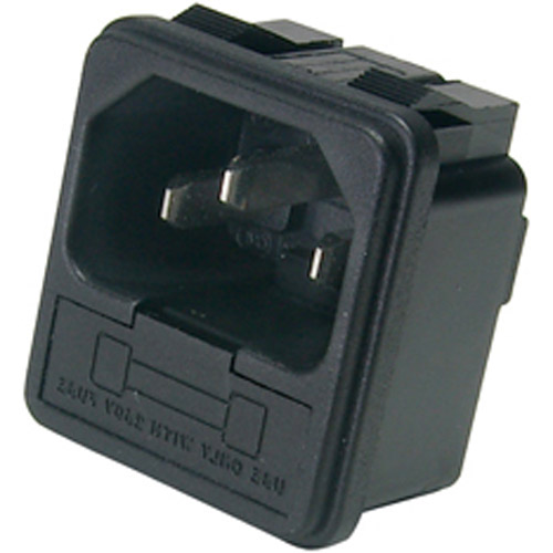

Anyway, I reached out to Fluid Audio and a very helpful support agent told me that he'd send me the schematic on Monday and that as far as he remembers, there *is* a fuse, it's just on the inside, on the powercable (which looks like this):
So yeah, if I get the schematic I might just replace the fuse myself and go from there. :)
