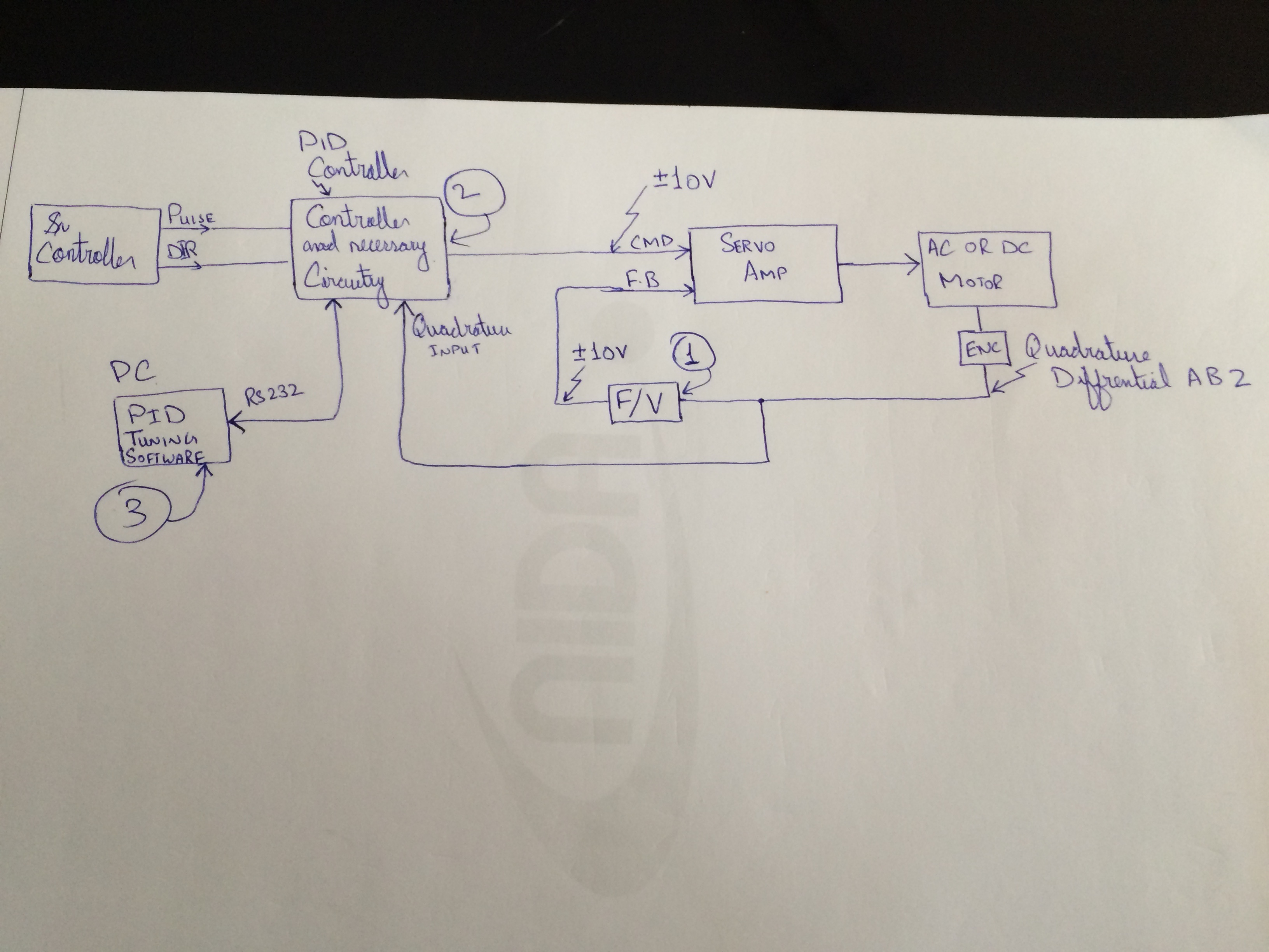

Thanks for Ronipson, for you reply actually, i have attached for the reference what i am trying to work on,
the mentioned 1,2 and 3 are the tasks i have to perform.
How i am going to convert this frequency to Voltage,

Let me make it simple, this is the setup for CNC machines, i have the controller but it gives STEP/DIR output and the problem is the servo amplifiers that are already available takes input as +-10v, precisely i am talking about FANUC servo drives,

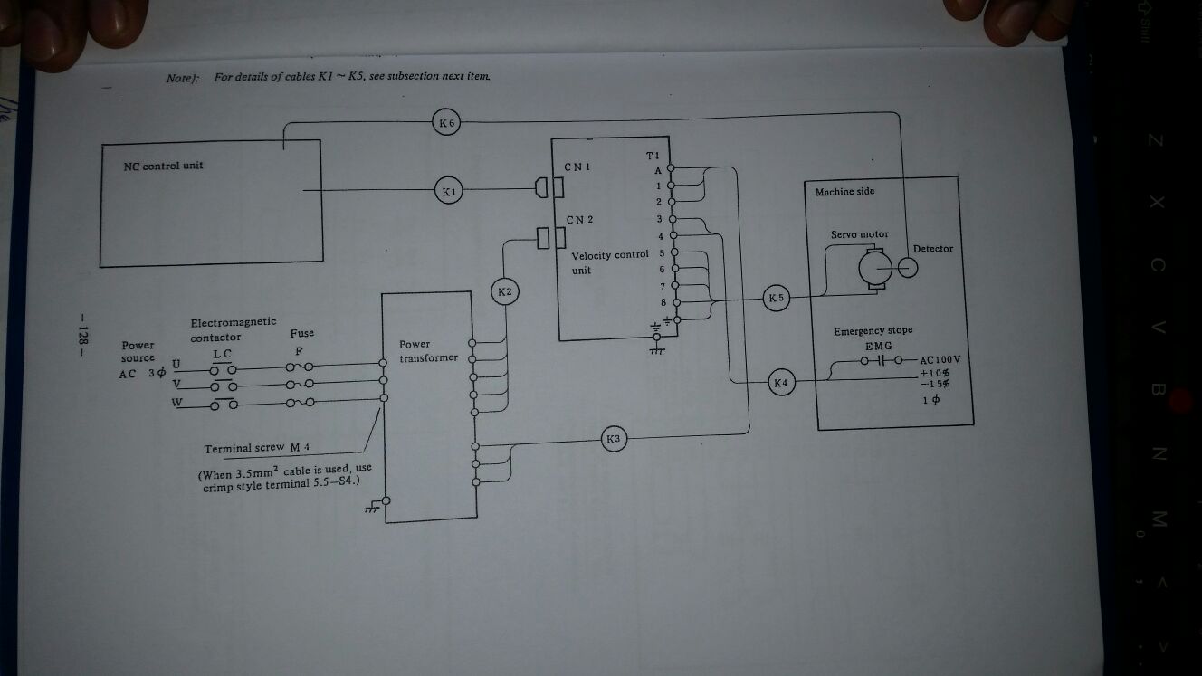

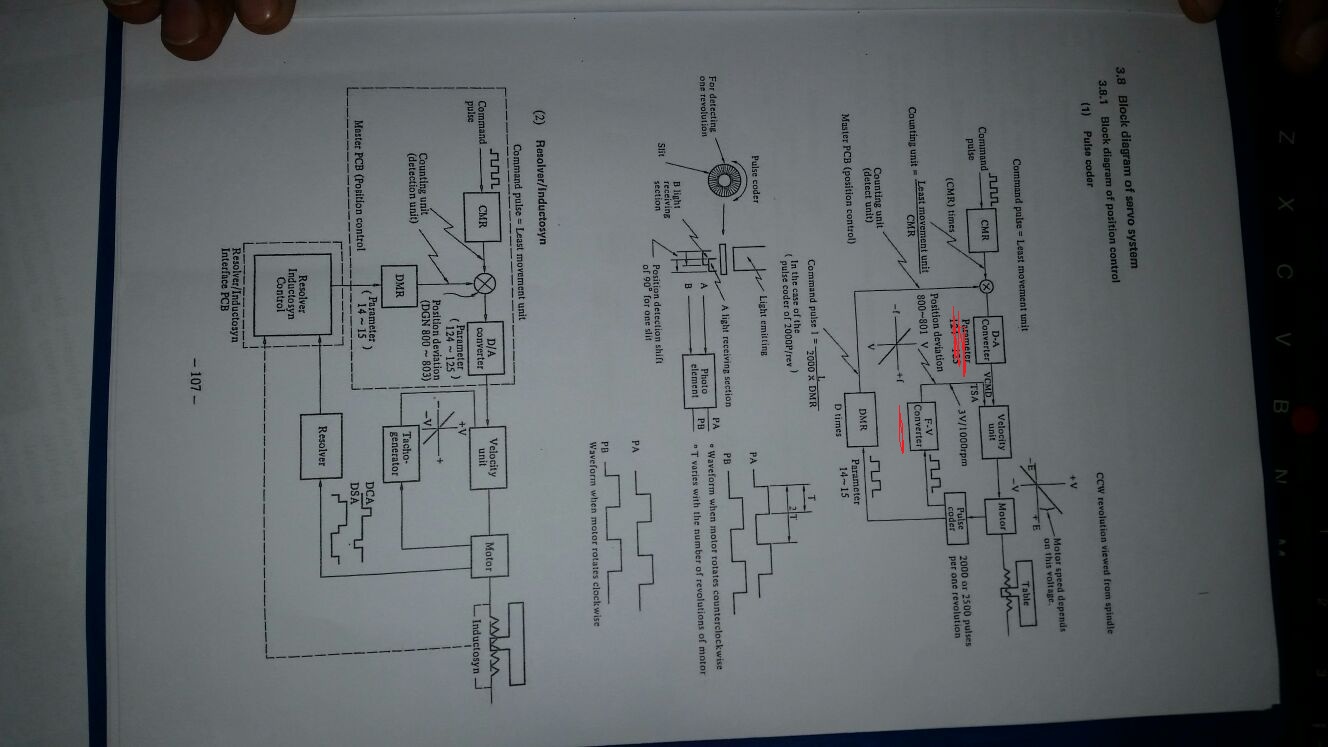

Now this is exactly the point i need to implement, the information you provided is really great.. i have read all of your post, now compiled some data to post to make the picture clear
1) I have the CNC controller which send burst of pulses with direction, this is controller is open loop
2) I have fanuc Servo amplifier and motor with encoder (2000ppr quadrature encoder), servo amp takes +-10v input
3) but what i don't have is the interface between the CNC controller and the fanuc drives, what i need
attached is the picture of original system
i have underlined with Red, what i needed.

Clearly this is not a design spec and just a simple connection diagram.
I guess this is not a design project, and just a buy project to integrate
