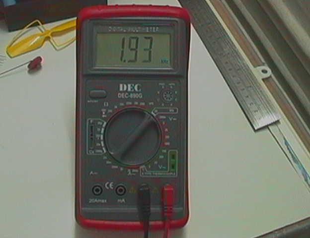

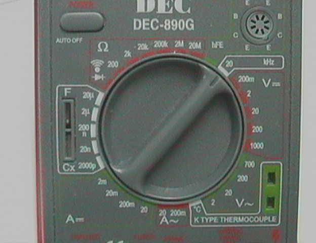

Hello friends,
i have a multimeter called DEC(DEC-890G) it has a frequency meter that is able to count 20kHZ MAX, i need to measure 100kHz max sometimes,
the only way i know is using from a convertor(made of CMOS or TTL logical IC's)i think i can use from 4017 IC but i am not sure if i have any alterative or...
by the way it is very good if someone says me how is the configuration for a such circuit?
any help would be very appreciated
