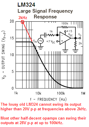

The LM358 dual opamp has exactly the same opamps as the LM324 quad opamp. They are low power so in addition to their horrible crossover distortion their slew rate is terrible.
Their datasheets don't even show how bad is their slew rate when they have an output near their max rail voltage.

I use MC34071 single, MC34072 dual and MC34074 quad opamps to replace LM324 and LM358 opamps when I want the input to operate as low as the negative supply which can be ground when there is no negative supply. Their max supply voltage is much higher than the others at 44V and they also work perfectly when the supply is as low as 3.0V. Their outputs also go down almost to ground in a single supply system.
They have no crossover distortion and have a good slew rate so the output can deliver 28V p-p up to 100kHz.
I use MC33171, MC33172 and MC33174 opamps when I need the low supply current of the LM324 or LM358. They have all the other features but have no crossover distortion and have a fairly good slew rate so the output can deliver 20V p-p up to 35kHz. Their max output current is a little less than normal.
