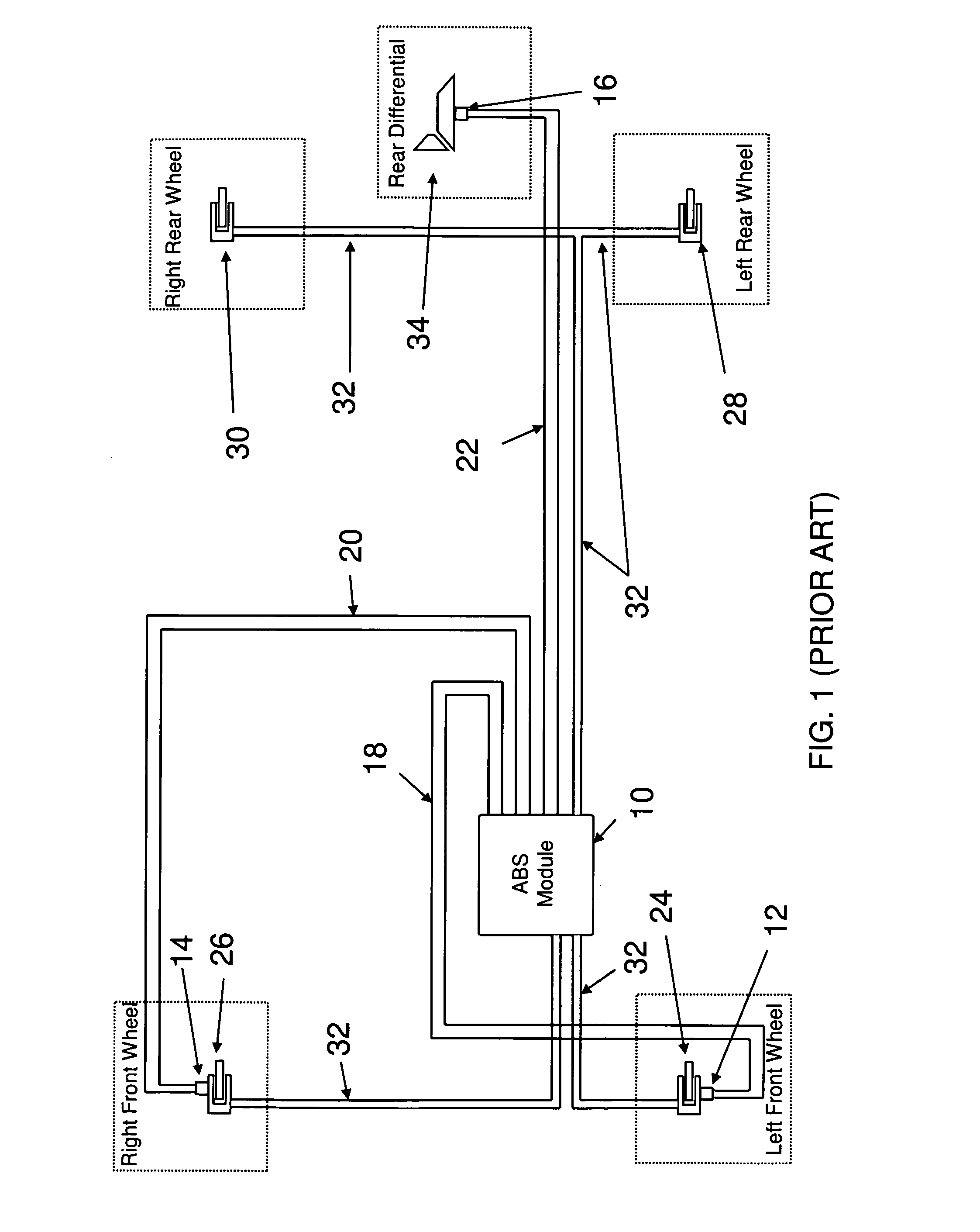

My car was designed for, but not equipped with, ABS. I am considering my options to install ABS on my car.
The ABS my car was designed for, was a 3-channel system. It had one sensor for each front wheel, and a sensor on the input shaft of the differential for the two rear wheels. To purchase all the hardware is relatively easy and cheap, except for the differential which can accommodate the 3rd sensor - even 2nd hand, that would cost more than the car itself. So I was thinking about installing a later 4-channel system, which would not invade the existing hardware.
But then I got to thinking that all I really need to do is to substitute the diff sensor with the average signal from the two rear wheel sensors, and I can use the original ABS system. Installing two reluctor rings on the rear half shafts and two sensors and brackets is easy, which is why I considered a 4-channel system to begin with. Then I wouldn't have to adapt any different ABS regulator, ABS ECU etc - it would be a straight install of the original equipment.

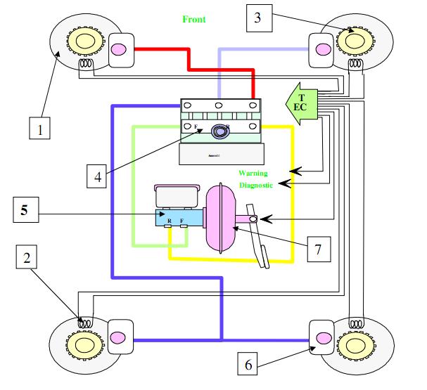

Here is a typical 3-channel, 3 sensor ABS system from the 80's through to the late 90's
Here is a more modern, 4-channel ABS with 4 wheel sensors:
Here is how I hoped to adopt ABS to my car - a 3-channel, 4 sensor ABS system:
