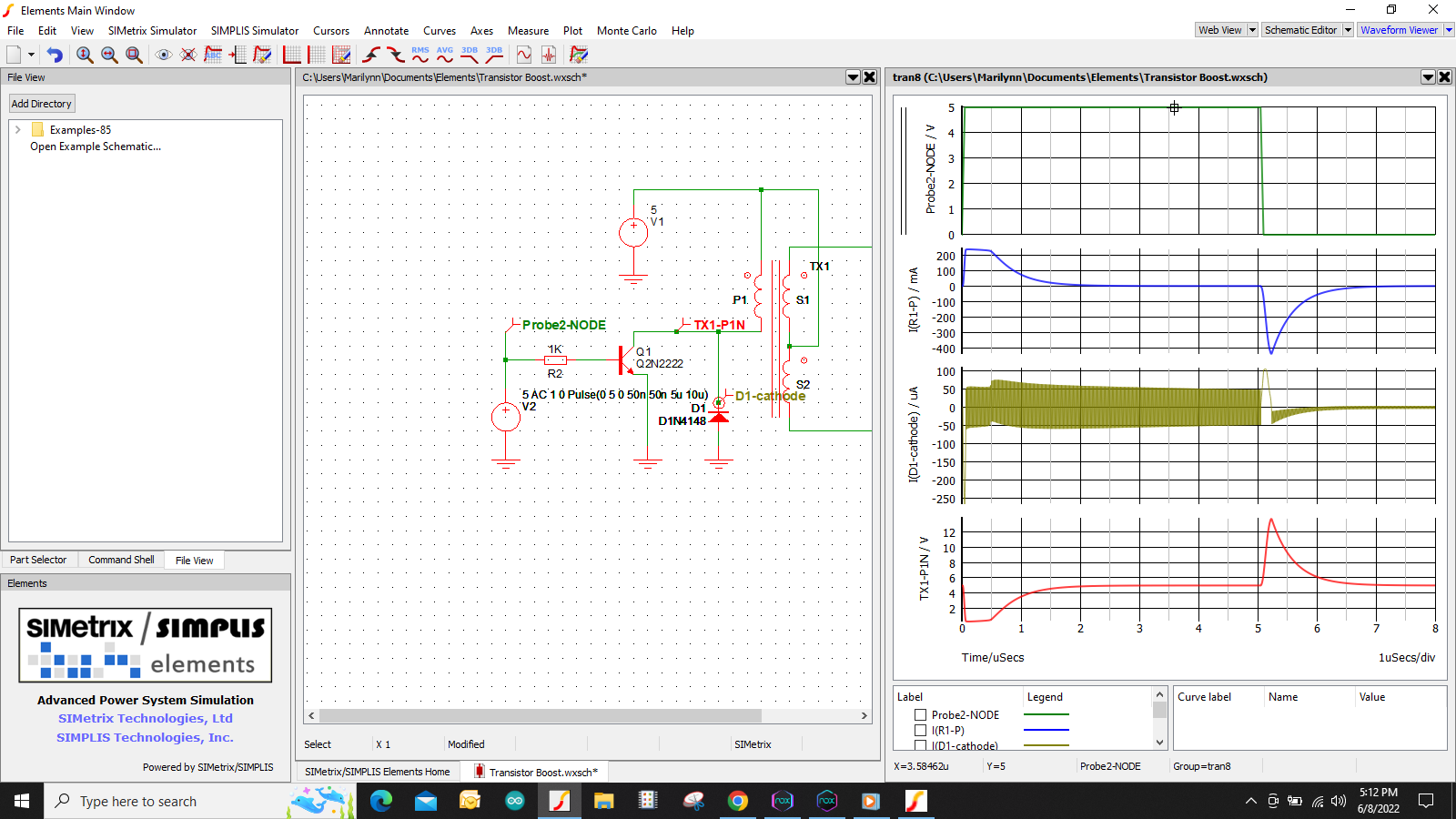

I'm mystified by the position of the freewheel diode, D2. Why has he put it across the driver transistor, and not the transformer primary?

The circuit appears to be a flyback type, and if you put it across the transformer primary, you would kill the output voltage.
D2 clamps the collector voltage to a diode drop below ground when the collector swings that low. In a flyback CRT display or TV set that would be called the damper diode.

If the voltage drops below ground, then the transistor will operate in the reverse direction to clamp the voltage.

Over here they were called efficiency diodes, it's a bit like the rectifier in a modern buck PSU - the transistor puts the energy in the coil, and the diode allows the energy to flow back round the circuit.

Why would you expect a transistor to do that?, and if it did it would likely be destroyed. It's basically a line output stage from a TV, and the transformer 'rings' with the applied pulse.

The voltage certainly won't be low - a TV line output stage, fed from 100V or so, produces a 1000V pulse on the collector of the transistor. In later years some LOPT transistors had the efficiency diode built-in - and if you replaced it with one that didn't have the diode, you had to add an external diode, or the transistor instantly failed.

But by all means, remove the diode and see what happens - monitor the input current and output voltage before and after, just in case the transistor does survive, to see if efficiency drops.
The circuit isn't tuned, so won't ring properly like a LOPT stage, so it would be interesting to see what happens.
Does not seem like diode does much at all -
Of course I do not have all the correct P/N's, xfmr specs.
Timestep step at 1 nS, diode spec is good for 4 nS.

Q1 is a low-side driver... when it turns off the transistor collector->inductor connection will try to go +++ in the positive direction, so what would that diode do? I don't see it ever conducting the way it is now, and nothing is protecting the transistor. In the original, it's a BD137 which has a Vce rating of 60V, so since it's only switching 5V that probably explains why it never blew up.
If it was a high-side switch THEN it would go negative.

It's not shown as one, and no reason for it to be one - it looks obvious it's 'supposed' to be an efficiency diode, as used in CRT TV sets.
However, it's quite likely that the circuit is just poorly designed, with the designer copying the idea from TV LOPT.
